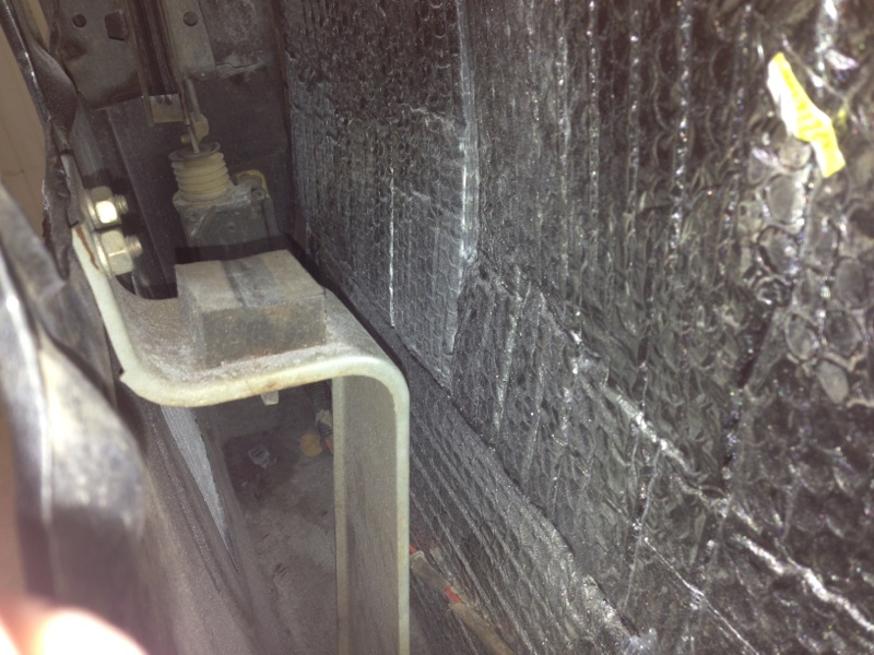

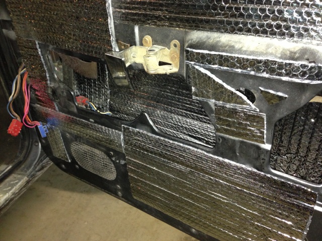

I installed this stuff in my truck today. It's just some roll of 1/4" plastic insulation I got at Home Depot. Also bought a can of 3M spray adhesive to stick in on with. I put two layers inside the doors and one layer on the outside of the door shell where the door panels go. I drove about 50 miles today with the door panels off and, I must say, there was a good amount of noise reduction even without them on. The insulation took a lot of the "tinny" and metallic noise out of the doors. I'm hoping to purchase some Dynamat for the firewall and floors whenever funding becomes available
i used this stuff too on the floors and doors, was definatly much cheaper, i just need to do the walls and the roof now
of course im not sure if the insulation i installed made all the difference or repairing all the cracks and rust holes in the floor board or a combination of the two lol
