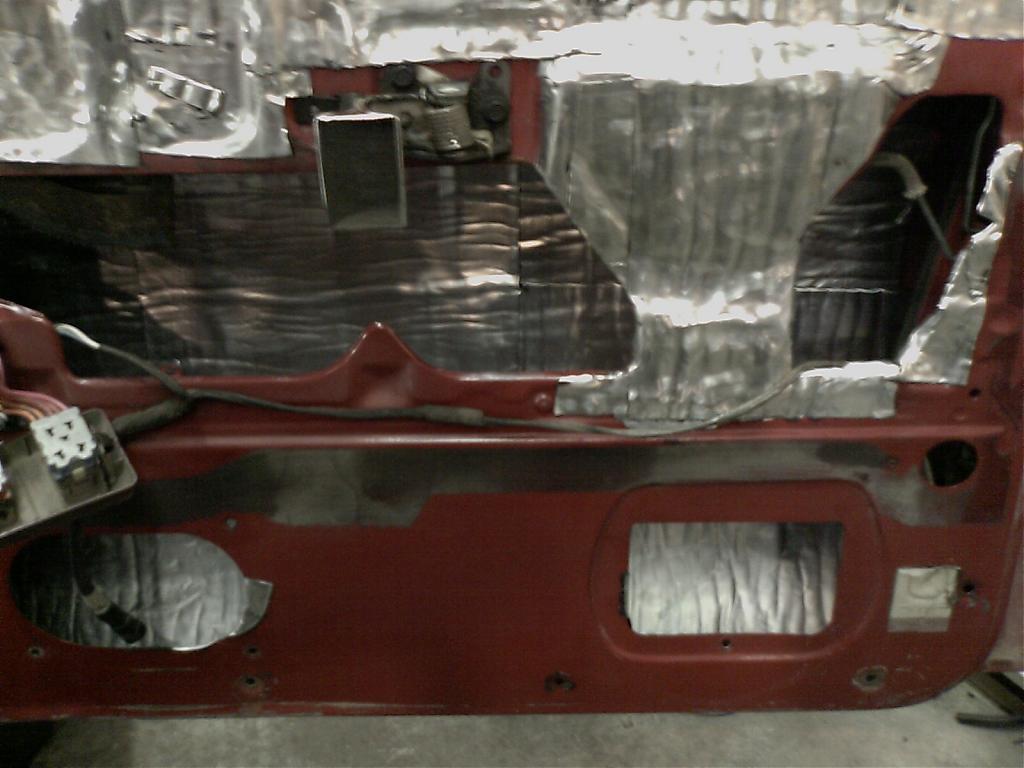

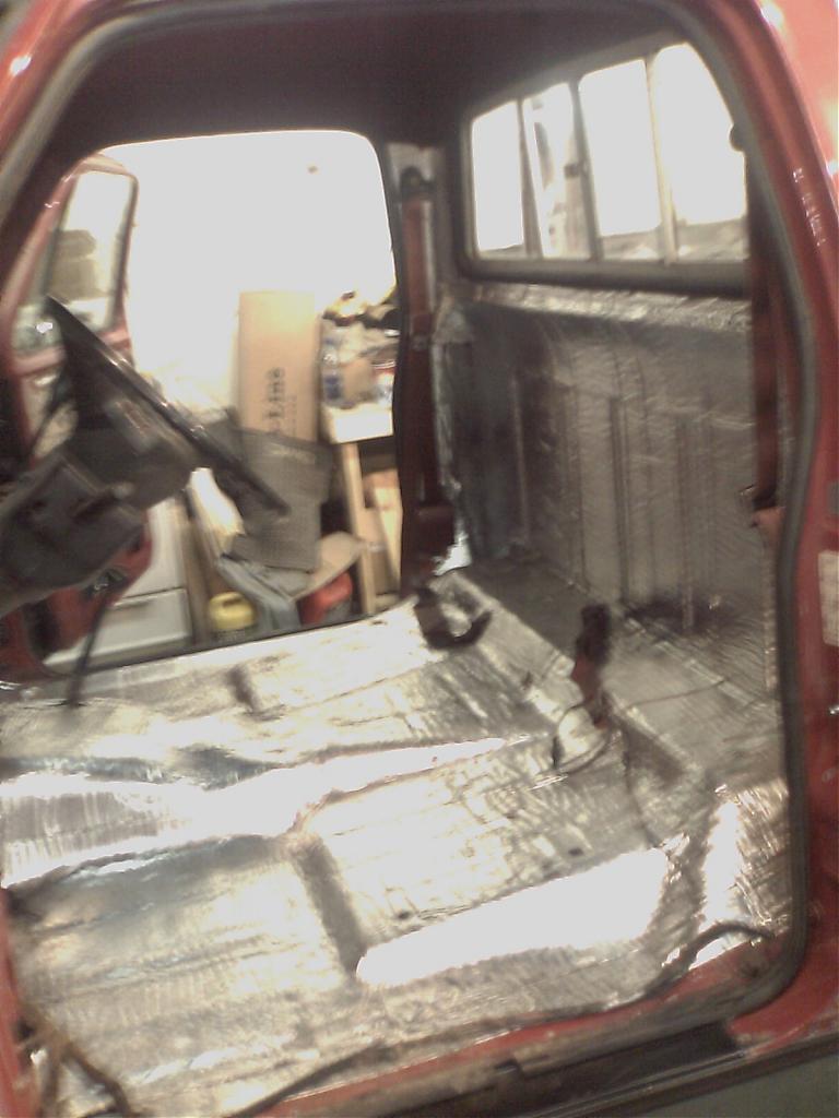

My 91 had a bad life . I had to gut its interior and start from scratch. After tearing every thing out and sanitizing/scrubbing the steel panels I laid sound deadner. I covered the floor, back wall, firewall, rear pillars, roof, doors and the cavities behind the doors. I also lined the door skin from inside the door. (see pic) I used two layers on everything and three layers in a few key spots. I expect this too be much quieter then my 90. My prefered brand of sound deadner is Dynamat but I got a sweet deal on some stuff called B-Quiet. I like the dynamat brand more as its thicker but the price was right. I have access to a DB meter so maybe I'll get a chance to mic the DB level inside the cab at some point. Anyway heres a couple pics. I wont know how good the stuff is till next week, it'll finally be on the road then.
