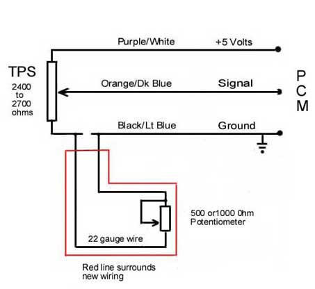

Old Jul 18, 2013 | 10:13 AM
  #113
infidel's Avatar
Posts: 14,672
From: Montana

Originally Posted by infidel
Old Mar 26, 2014 | 04:39 PM
