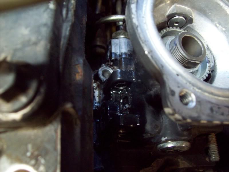

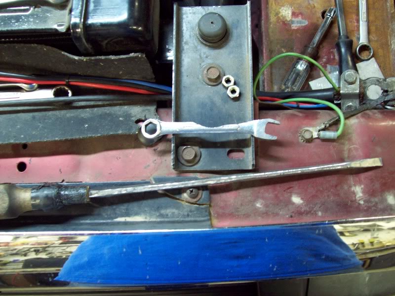

Well I got after it last night,was able to get all the allen head bolts out of the top of the pump.The back idle adjustment screw was a nightmare,modified some tools to get the job done.I have so many wrenches cut and welded back together in weird shapes and skinny looooong screw drivers etc,etc, since Ive got this truck lol there kinda of PIA to work on with normal tools...need a set of crows foot sockets!
The toughest screw was that pesky backside allen head.Took me about an 1 1/2 hours just to get these 4 screws out.

The custom tools a ground on to get at that locknut and turn that idle screw out with.

Tonight or sunday morning Ill pull the cap off and swap the gov. spring
While im getting dirty Ill install the M&H dynamic timing spacer in there also.
These 2 items should make her buck a bit

PIA indeed lol But I got it done,took me about 5 hours with a couple of (I better walk away before I get ****** off breaks)
The truck now has the 3200 rpm spring and the dynamic timing spacer,I ws going to grind the fuel pin also but I figure 2 mods at once is plenty(how could I know what the fuel pin did?)
Anyway WOW!!!! what a differance that spring and spacer made SKOCKED! I cant wait to pull a load now!
Thanks for the great advice and the boot in the *** to get after that spring mod!
