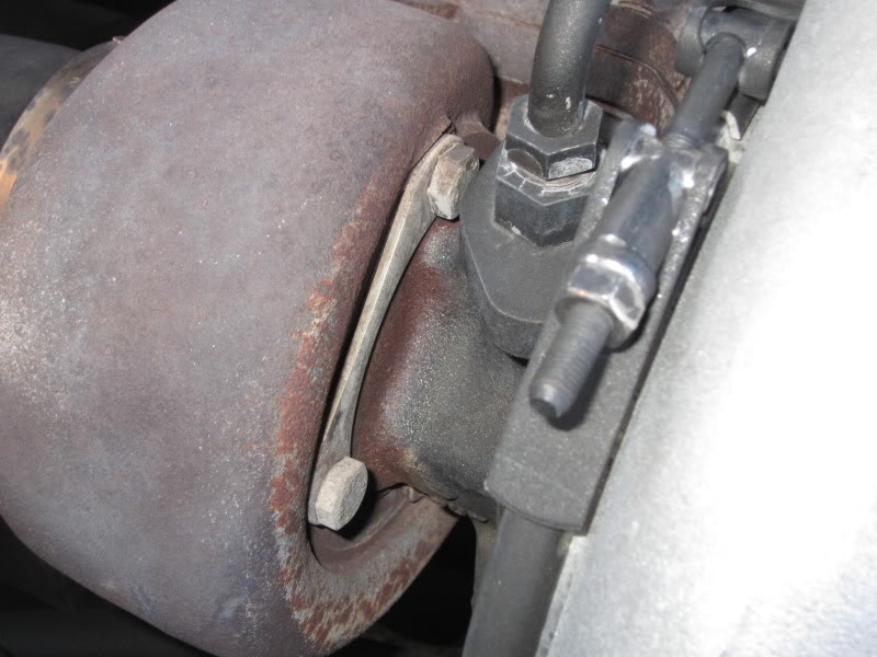

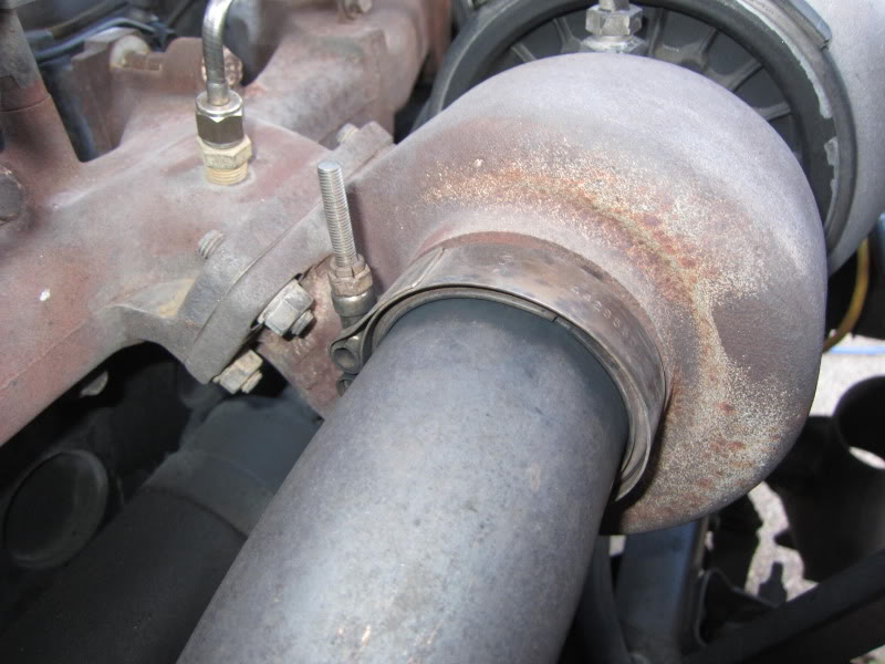

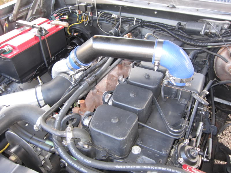

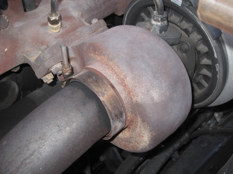

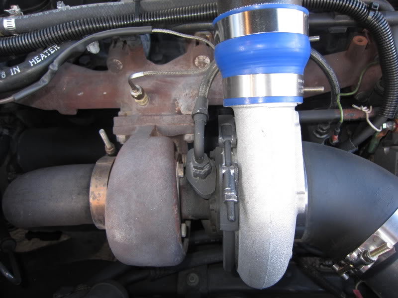

I will have to check and see what the housing looks like, the guy at ADP BECS took a new one off the shelf to show me and the wastegate actuator I am sure was on the turbine housing, I am just hoping is a 14cm housing.
I have an exhaust leak from the back flange that I have not investigated yet but my clamp is about as tight as it will go so something is worn, maybe just the flange.
I have a A-727 trans so there should not be to much turbo barking unless maybe a panic stop from 100 mph.
My engine/ turbo is fairly clean and rust free so it should come apart fairly easy, what do you think?
I have the heat shield off the firewall temporally but I think there is enough room for the downpipe
I guess there is a little dust on it.
Jim

Jim...I'll almost guarnatee you that your exhaust leak off you down pipe is actually the flange on the exhaust pipe, that the V'band clamp squeezes. I had this on my truck as well.
I believe mine cracked from all the vibration and movement from it not having the lower bellhousing exhaust clamp to hold things steady and secure.
