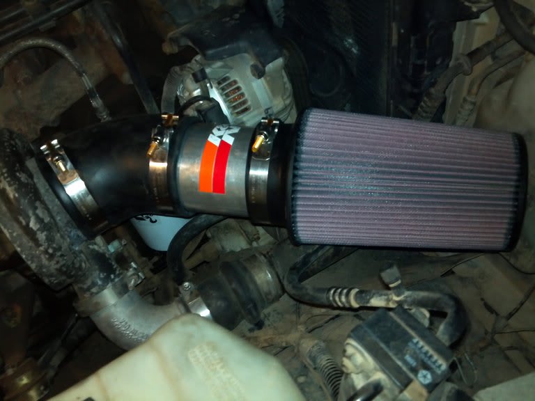

Got in some parts I ordered the other day from intakehoses.com. I just bought the rubber 45 the T clamps and the 6 inch piece of aluminum pipe. The K&N came from a local hot rod shop. I think it came out nice and it makes my new to me hx35 scream .

Well I'd have to say you did a nice job on the execution BUT I don't think you'll get a lot of thumbs up on the K&N filter. It's the general concensus that they are not a good idea, especially with a diesel engine. Do a search on "K&N" and you'll see what I'm referring to. There are some posts noting actual impeller damage attributed to a oiled air filter.

Ya , I went with a BHAF from Napa rather then the K&N. I also made a heat shield

If that oiled filter is the problem then I'm sure it wouldn't be a problem specific to just k&n. I had over 100k on an oiled filter on my 01 cummins without a hitch. Though I'm not sure how more lubrication would hurt a thing.

K&N's are thinner for the higher flow, and they oil them to make up the difference.
but they still don't filter that well compared to a paper, My trucks had a K&N in it for a long time and when i took my silencer ring out it was black with dust in there.
One thing that will help is a Outerwears Pre-filter, if you're dead set on keeping that KN.

Its not the oil, its that with the addition of the Turbo, k&n's media lets small debris through. I have more than one friend that is or was a ford tech and they all said that ford wouldn't do anything with turbos, or blow by if the trucks came in with a k&n filter on them

my truck has 320,000 k with a K&N, also the fact that if you are having issues with dealers denying warranty due to installation of their product they will go to bat for you. seems good to me.

I'm still a K&N and oiled filter fan. I run a AirAid oiled filter on my 05' Dmax and not a problem in 226,000 miles. The turbo blades are still clean looking and no problems with the MAF sensor.
All my other vehicles run K&N as well. Sure, a BHAF will filter out smaller particles. No denying that, they are great. But what do they flow? How fast to they get clogged with those tiny particles and start dropping off airflow? In all my applications the higher airflow for the size is why I go with oiled filters. That fine dust is like rubbing the cylinder bore with 5,000 grit sand paper. You are far more likely to wear the engine out before you see any knoticable illeffects from the K&N.
Just my $0.02.
Your intake looks good BTW!!!
