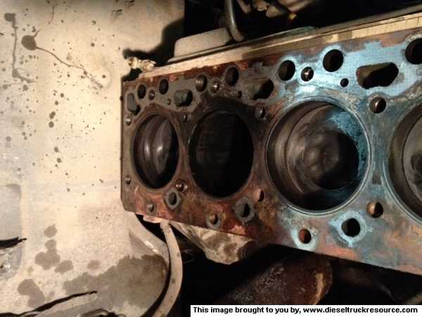

Took the head off my truck tonight. The only thing obvious was the bolt between 3 and 4 was carboned right tight in its hole. Is the normal? Didn't see anything really wrong with the gasket. Broke 3 manifold bolts off in the process. At least the head is out and easy to work on.

cleaned up the block a bit to take a picture and it looks to me like number 5 was leaking. It is really black on the drivers side of the block and it was the bolt between 4 and 5 the was stuck in its hole and the bolt between 5 and 6 was a little hard to pull out also. What is the quickest way to get a photo up on here?

So here is what I'm looking at.

Is number 5 hole scored?

Just went out and wiped it out and yes it is scored a little. I guess this just turned into more than just a head gasket.

So I'm thinking I need to pull it out to have that repaired.
