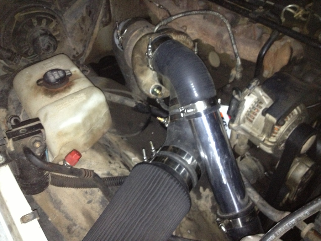

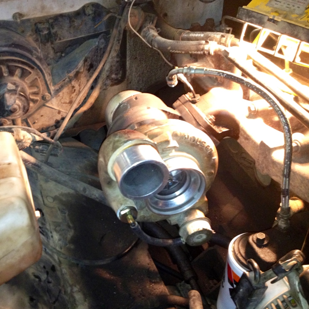

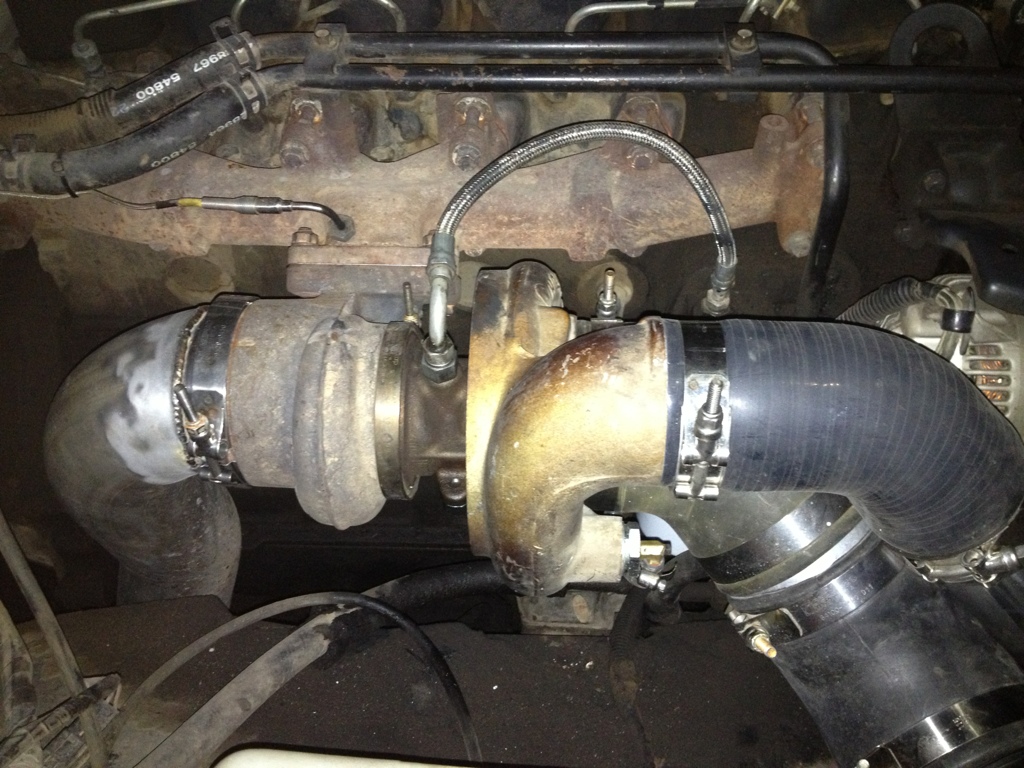

I say go for it I just got mine all buttoned up and love it. I left the housing clocked so the waste gate would be functional. I have it set to open at 38psi.
