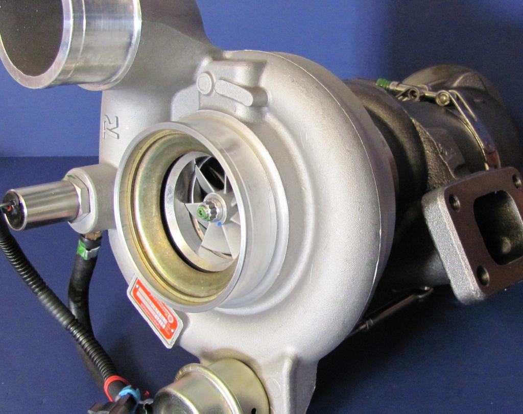

Here's a couple pictures of one. Looks like the output would be on top instead of the bottom

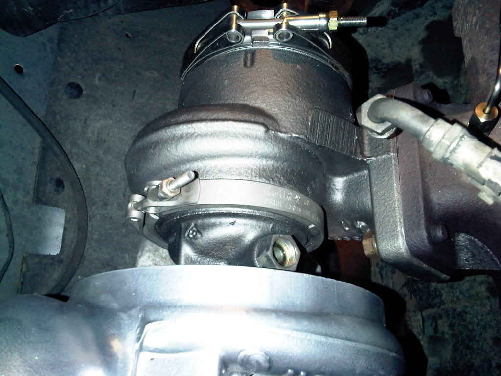

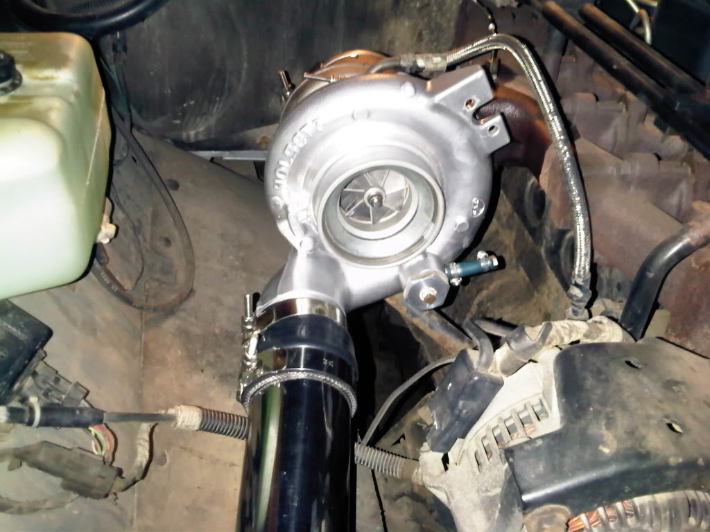

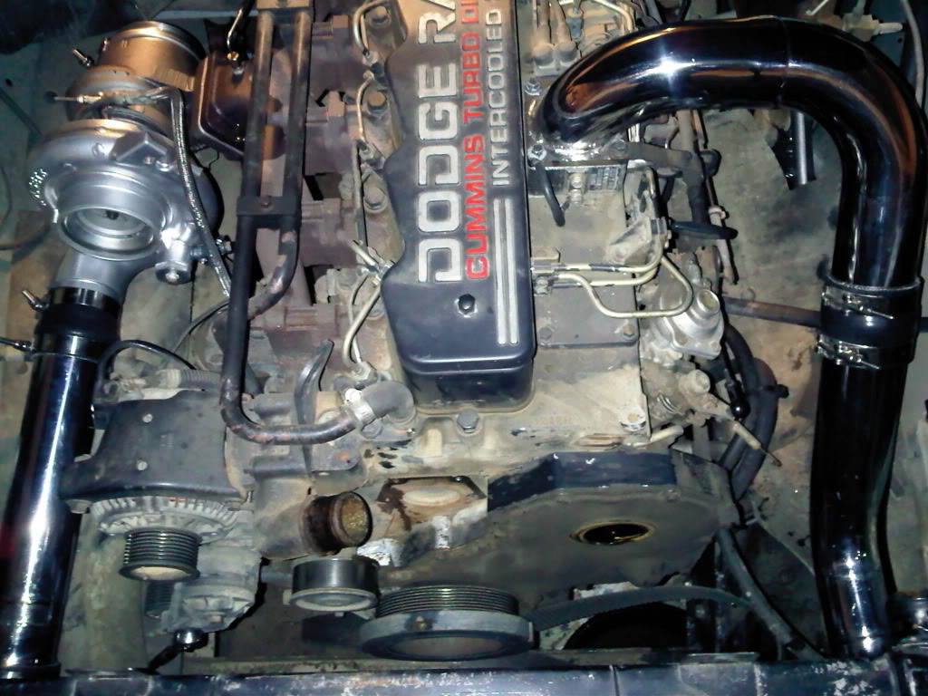

Here is a pic of mine installed (clocked and unclocked).
When it is clocked you cannot use the stock WG, you will need to modify it, tack the gate shut or use a spring gate (best option). Unclocked causes the oil ports to be on a ~15 Degree angle which is not good for draining of oil and it may back up into the turbo. The silicon IC hose does not work for a 1st gen truck/IC, just an FYI.
