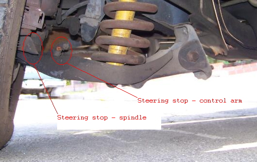

The "normal" full lock clunk/scrape/pop is due to the suspension flexing while the steering stop is touching the spindle. The metal-on-metal sliding under extreme pressure makes a nasty but not harmful noise. The stops are supposed to be greased so they move smoothly and quietly but I doubt many of them have been greased since they left the factory. Mine aren't - I know why it makes that noise so I don't worry about it.
