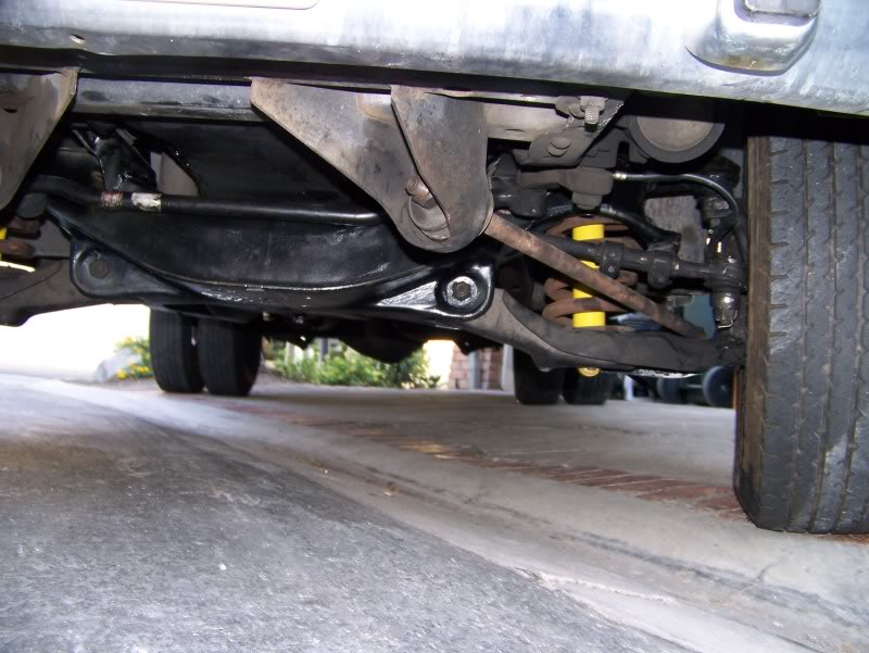

slowly but surely...
the X-member is almost entirely in. i decided to go with some fine thread 7/16 grade 8 bolts with toplock nuts as they were affordable and readily available.
even after a good bit of wire brushing the thing was too filthy to even tack with the tig, so i did it all with the mig. my little Matco 180 kinda sucks, but i got her did. the paint is too shiny, but i dont really care. it was cheap. pretty soon i will be able to actually start putting things back

On the Road again!
well i have to move and i made a mad dash to get the ol' 89 back on the road. front end sits noticeably higher. not sure if its the new shocks (the old ones were very tired) or if the springs stiffened up a little after being out for several months. anyway it looks like it almost rides level now.
