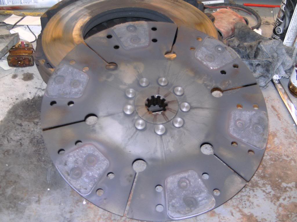

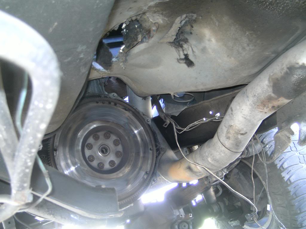

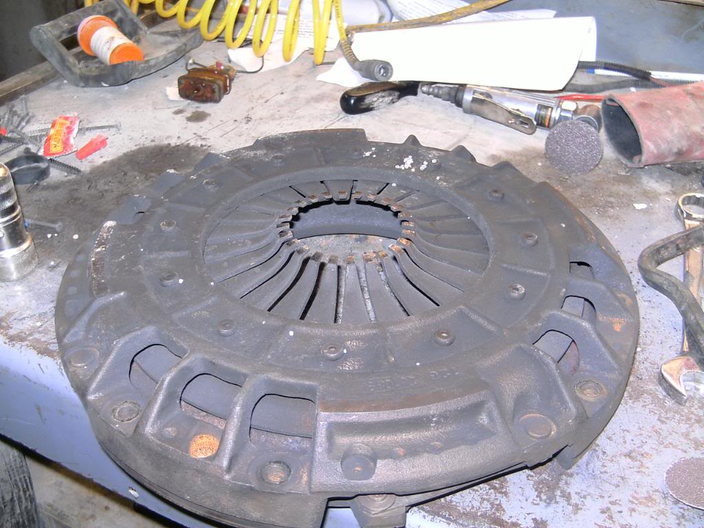

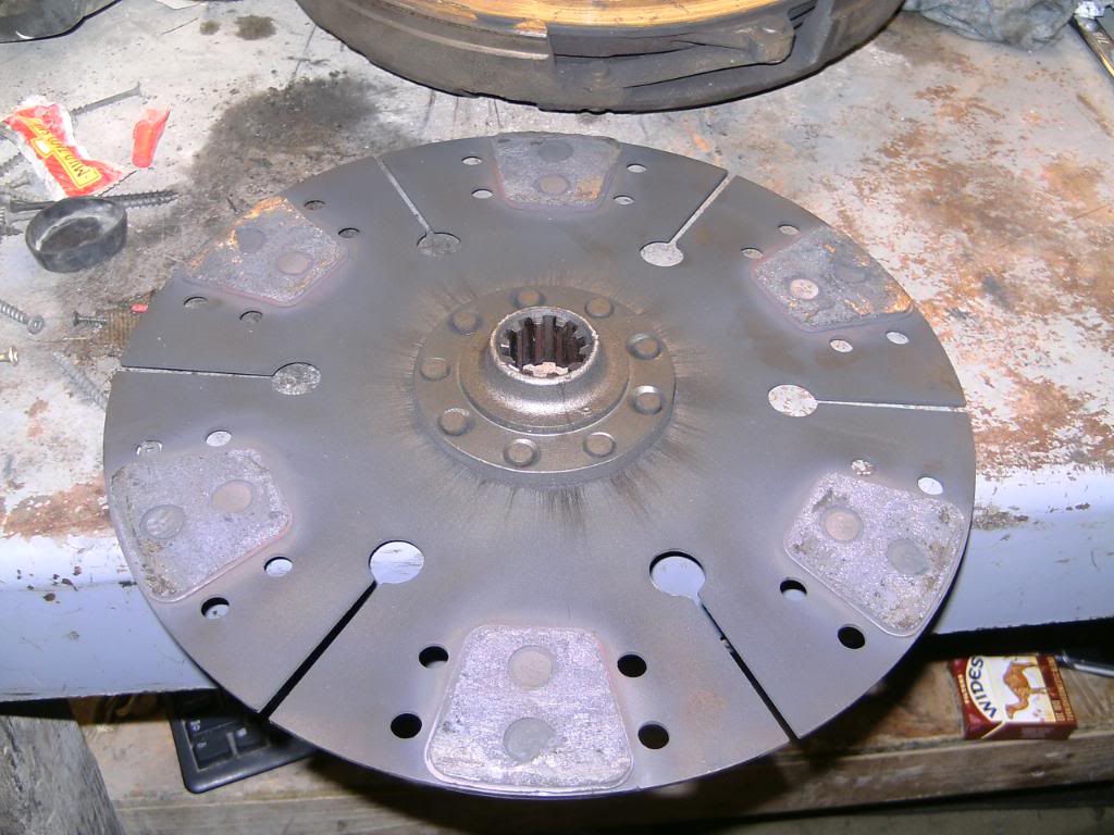

Well, its out and going to get relined tomorow. It wouldn't even hold a little brake stand anymore.

When you have a clutch relined do you replace the pressure plate or just reuse it?

Just clean e up and re use em, Have you ever priced a new SACHS Pressure plate?

No I have only messed with clutches in gassers. That's why I asked I was wondering if it was different. In a gasser I would have replaced everything.

Who does a clutch relining? Do you get the pressure plate resurfaced or scuff it up with emery cloth, or the like?

your gonna have to resurface that flywheel

pssh, that ain't bad. When it gets a gold hue from the heat from slipping is when you got a problem
(honda with a turbo. stock clutch didn't like 300hp/275 ft lbs)

I get all my clutches relined localy at Lincoln Clutch and Brake. I just scuff em up with some 100 grit and go.
Why an I gonna have to resurface it? After 1 hook or boosted launch it will look just like that again, I'll just scuff it with some 100grit like I always do to give the clutch somthing to seat to.

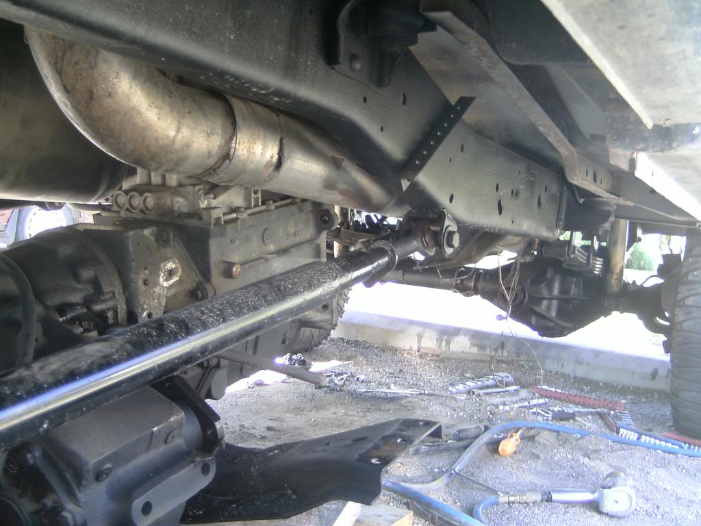

I would have never guessed that your frame looks as good as it does. It's got more paint of one color than the rest of your truck!

Randy, I just put a fresh rattle can job on the frame and other chassis parts last week.
Bill, I would bet it would, I beat the snot out of mine on the street, lots of brake stands through the gears. When "testing on the street I could bark the 35's when I banged 4th.
its pretty cheap too I had my local clutch shop build me a new disc and it cost me 134$

Truck is back together. I would normaly have more pics but I ended up leaving my camera on top of the spring . This new disc seems like it might take a little bit to seat in.
