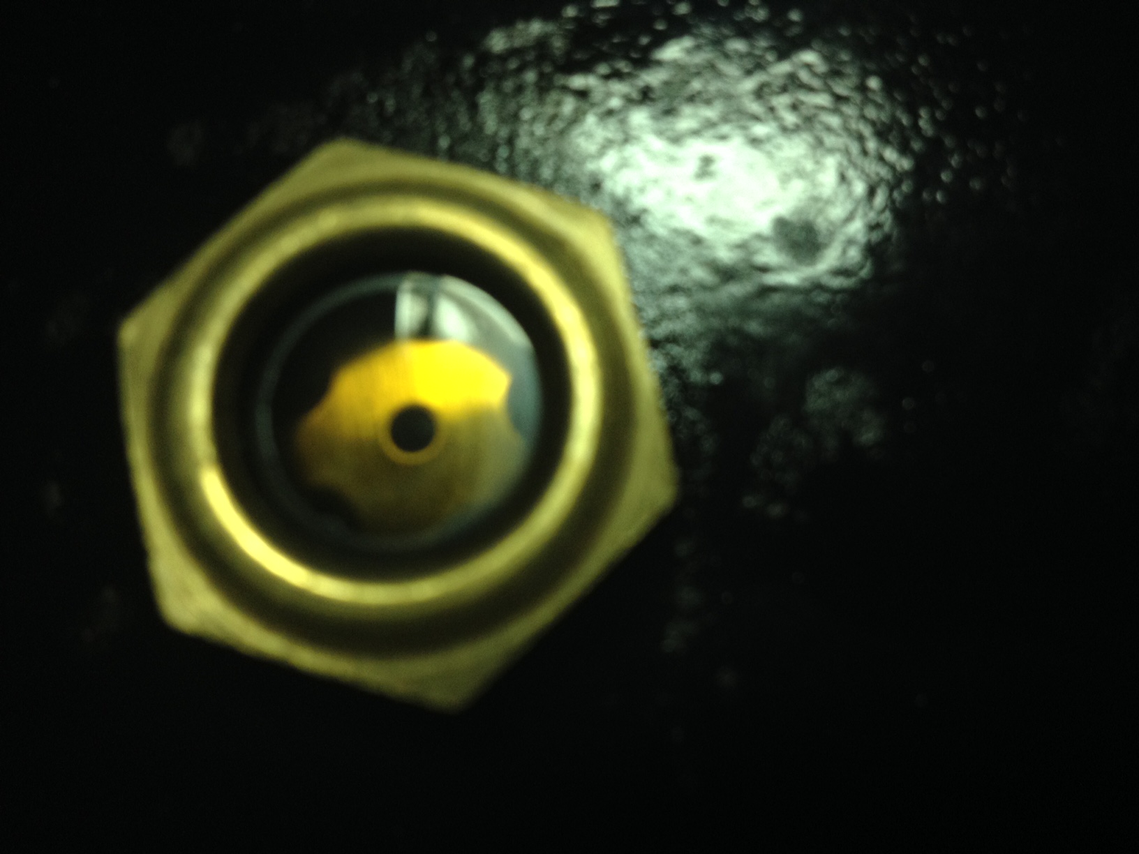

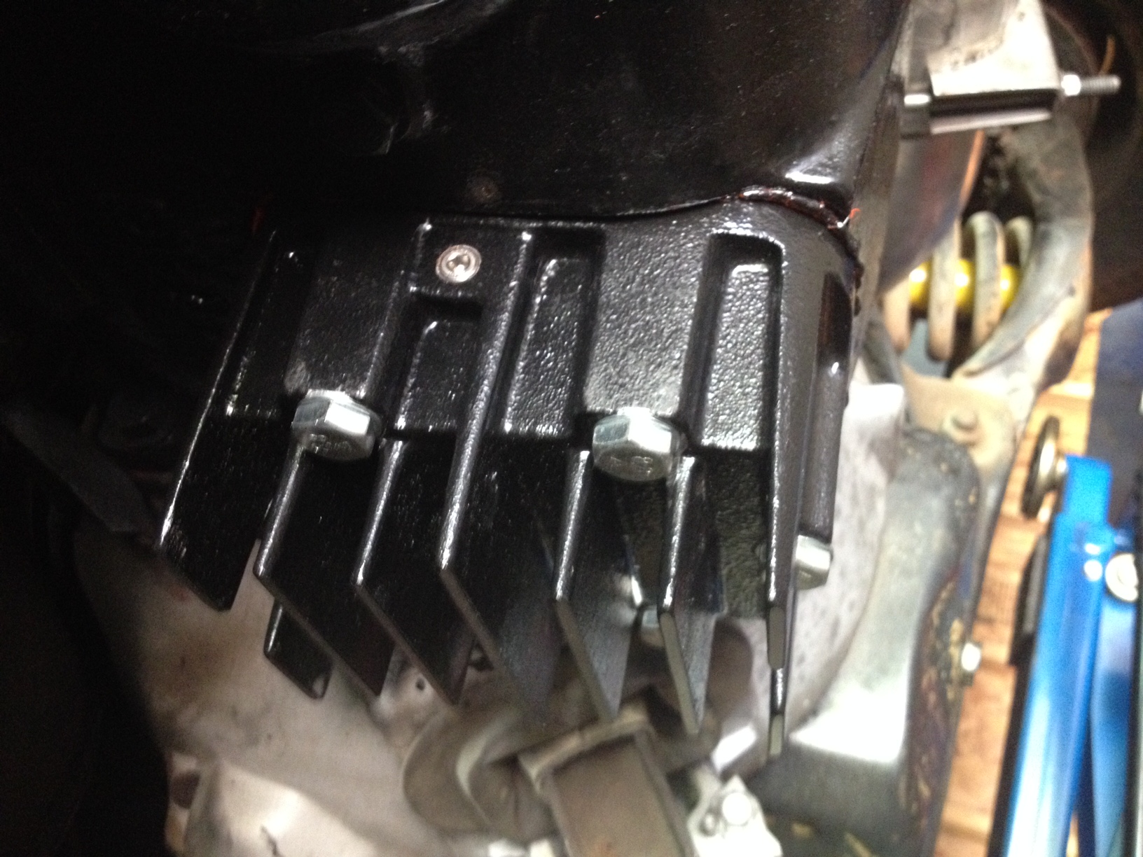

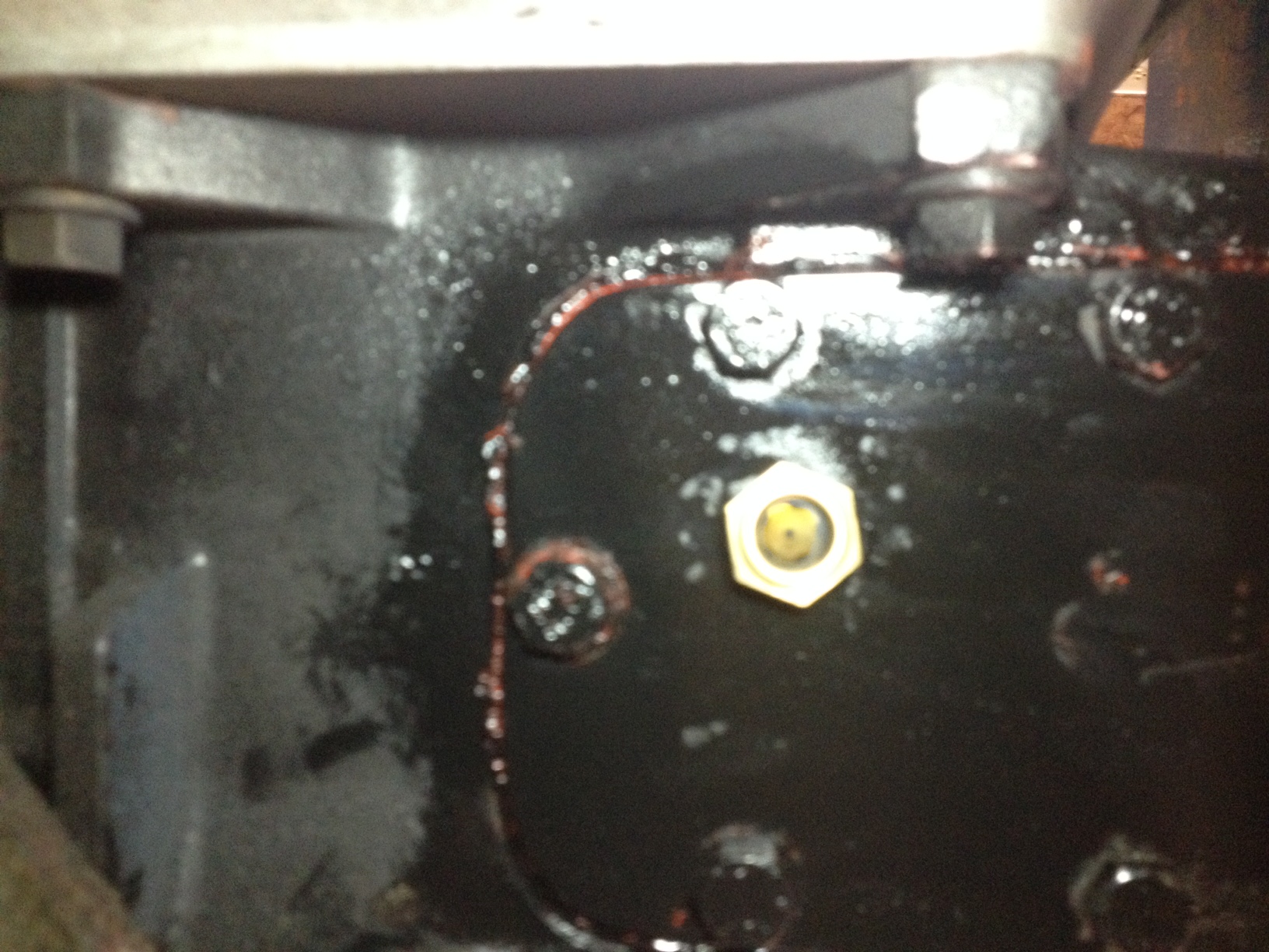

this is what i have plus an electric pump to an oil cooler in front of intercooler, i think 11 or 12 quarts amsoil
Attached Thumbnails Getrag sight glass-img_2545.jpg   Getrag sight glass-img_2546.jpg   Getrag sight glass-img_2548.jpg

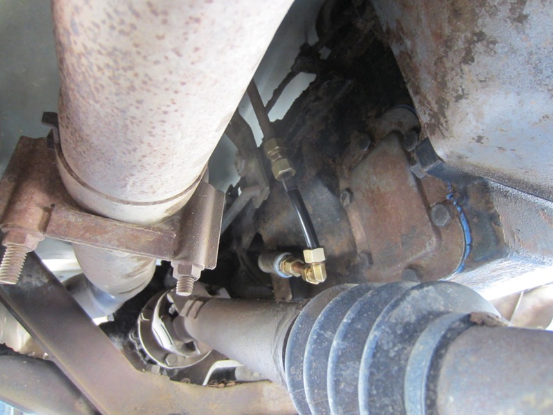

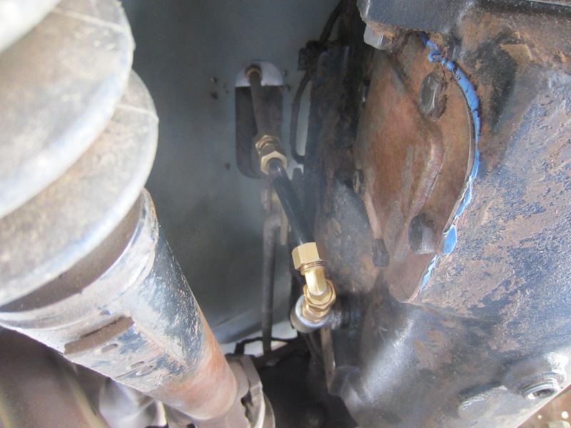

Here is what I did. Fill point is under the transfer case shifter boot.
Thank you,
BlueW250
Attached Thumbnails Getrag sight glass-img_1011.jpg   Getrag sight glass-img_1012.jpg
