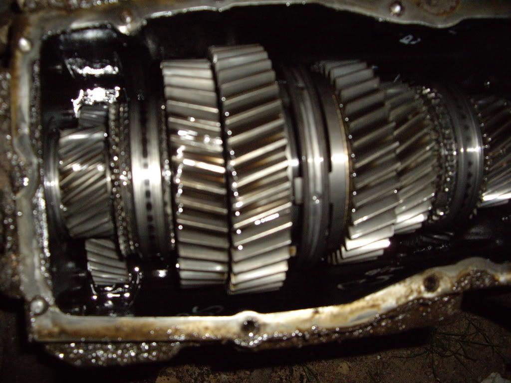

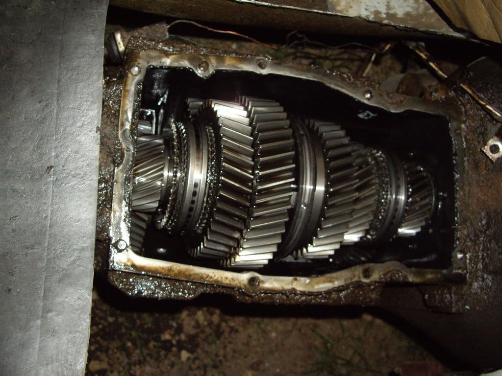

Ok gentlemen, my super dodge lives again! Took me awhile to get it done because I never got the chance to stay home until it was done. Had to keep going home for a day and then coming back up to where I go to school at so I could work my shift and then go back home. Then I had to find a welder, blah blah blah. The problem was obvious once I got the cover off the trans. Let's see if you can tell me what's wrong with this picture....
Lots of man hours. All just to put a roll pin back in its place. I'm just happy it didn't come all the way out

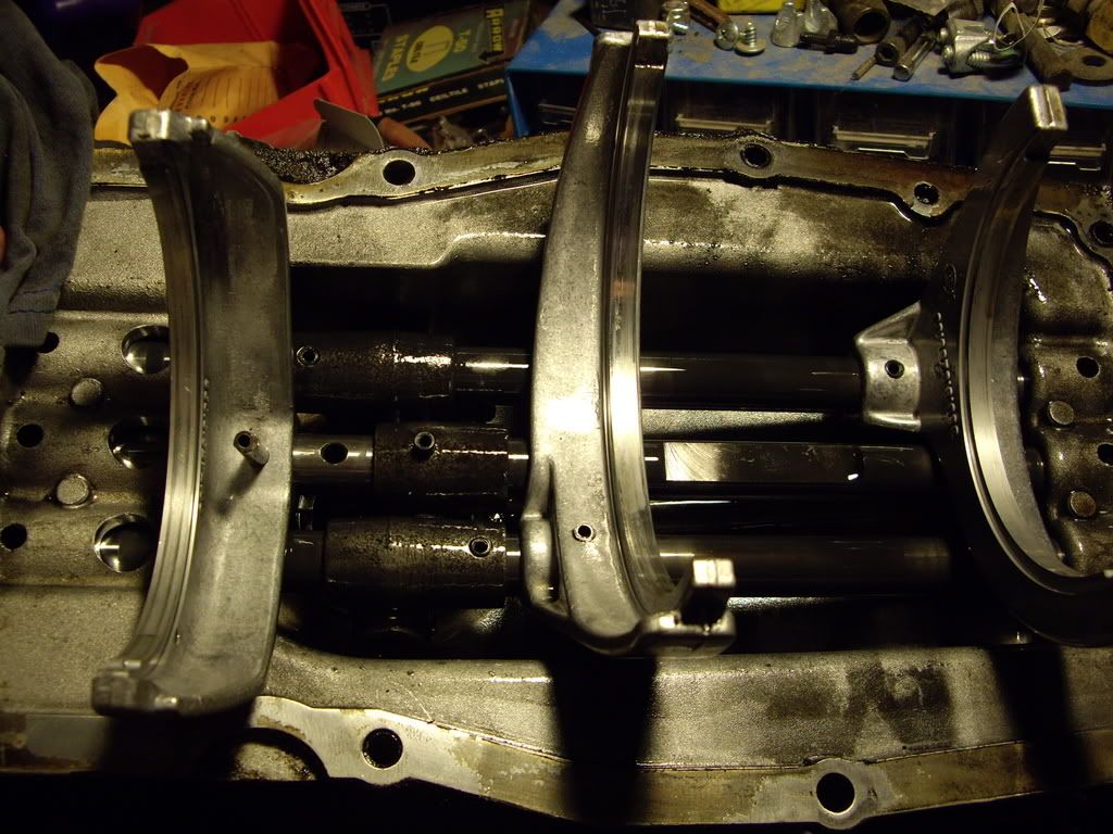

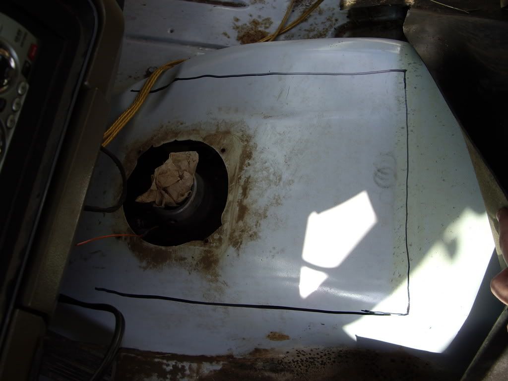

A couple other ones had started working their way out too but just barely. I made sure they were all properly recessed. I definately recommend doing the floor pan mod. It's very easy and it would be really quick if you have the time to stick with it until its done. Another thing that slowed my progress was the fact that a bolt broke off. Luckily it was still sticking out of the case a good ways. For those that dont know, the cover isn't threaded so I could still pull it off with half a bolt in there. Welded a nut to it and she came right out. I was a little discouraged when this happened because the one that broke off was the VERY FIRST one i tried to break loose.
Let's just say I was a little apprehensive on trying to loosen the other ones. Whatever shop rebuilt this, locktited every single bolt. They all had red locktite from top to bottom on them.
They never got finger loose until they were all the way out.

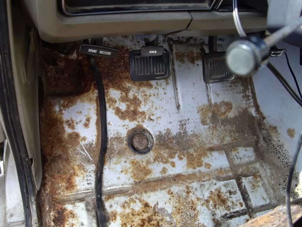

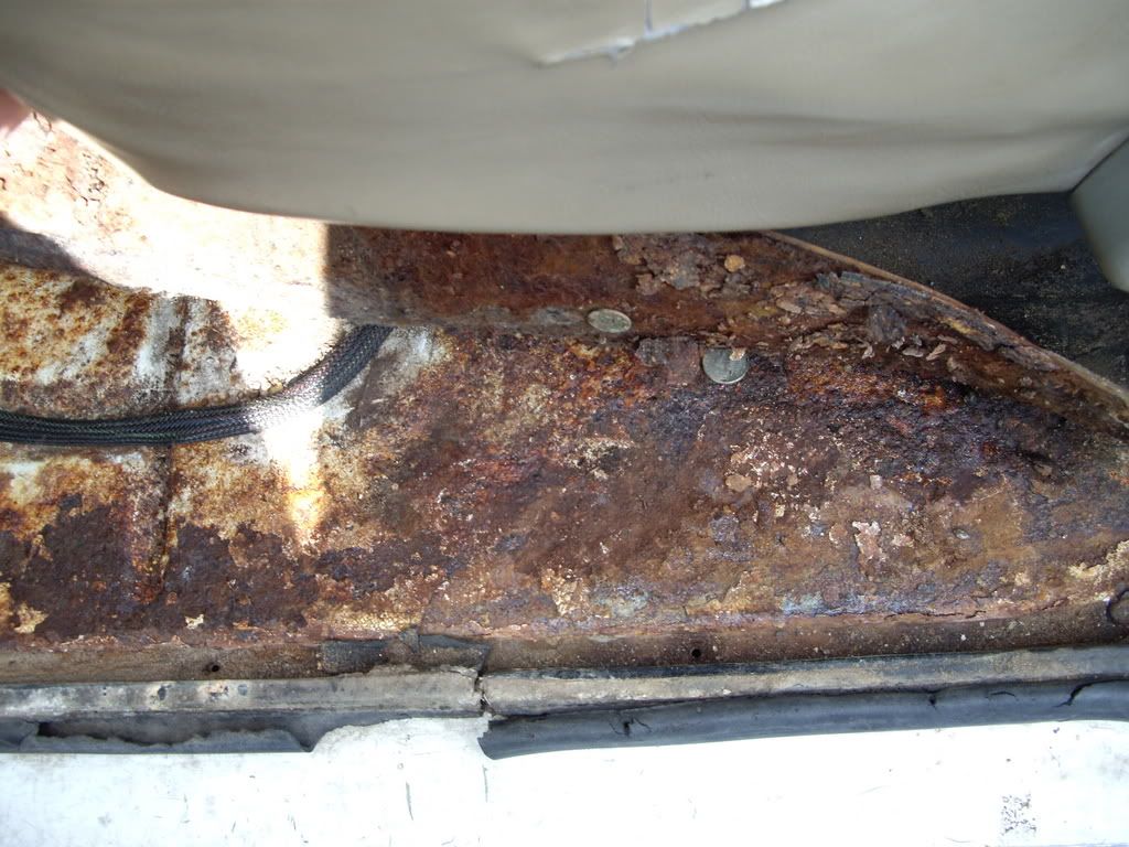

My floor boards were not pretty....
They never got finger loose until they were all the way out.And now some random pictures of the job...
