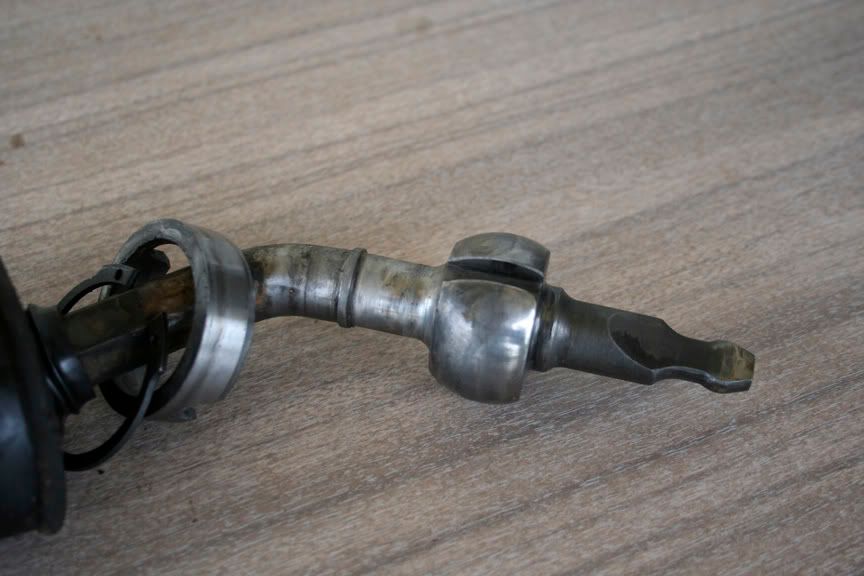

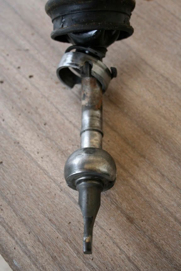

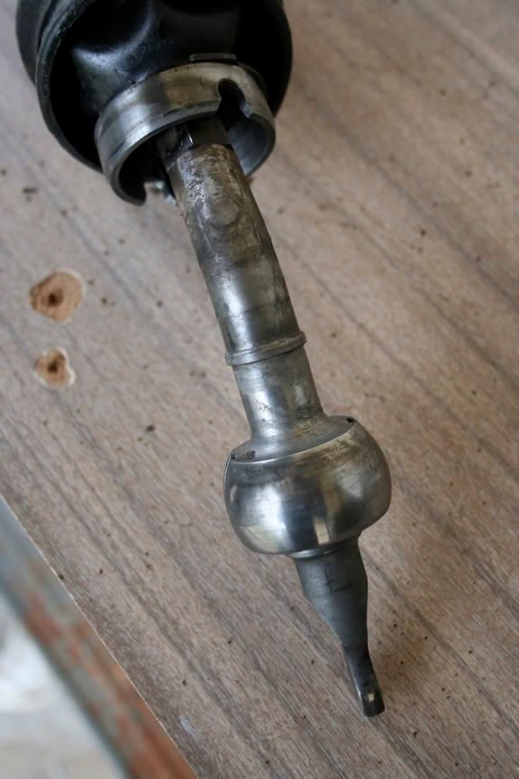

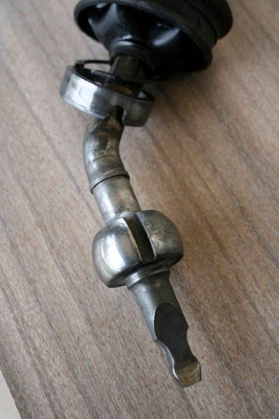

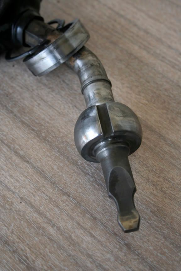

Ok guys, finally got some pics of the shifter end and the broken screw(which has nothing to do with it really). The shifter end looks great to me but then again I don't know what it's supposed to look like. I don't see where its been wearing though. Alright tell me what you think. If this isn't the problem then out comes the tranny.

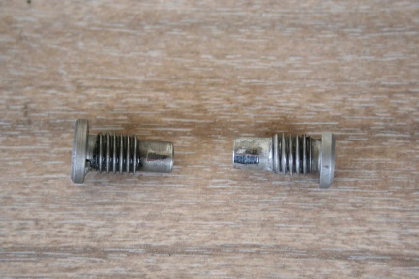

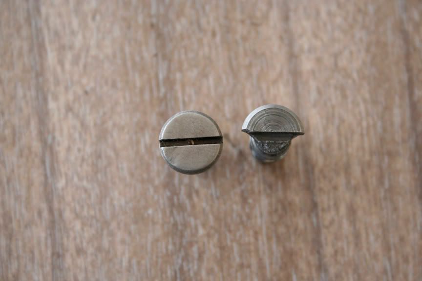

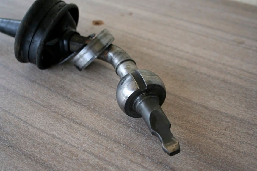

And now the broken screw. I'm posting these to make sure they dont have excessive wear or anything that could cause a problem. Several different angles. Thanks again
Old Apr 11, 2007 | 12:41 AM
bgilbert's Avatar
Joined: Apr 2005
Posts: 3,253
From: Terre Haute,IN
All looks normal. Here's a link to my gallery on the floor mod spoken of. Would save you the trouble of dropping the tranny. http://www.turbodieselregister.com/u...0&albumid=1315

Yep, there's no reason those parts shouldn't shift.

Thanks for the pics. Now I know what a good one's supposed to look like. Sounds like you may have a worn shift fork. This happens when a driver leans on the shifter all the time. The constant pressure wears the fork out. Used to happen with 3spd column shifters all the time. they'd get so bad that they wouldn't stay in high.

EDIT: also where do I get a new bolt? since the one is broken

Don't sweat the bolt head, just put it in with some loctite.
