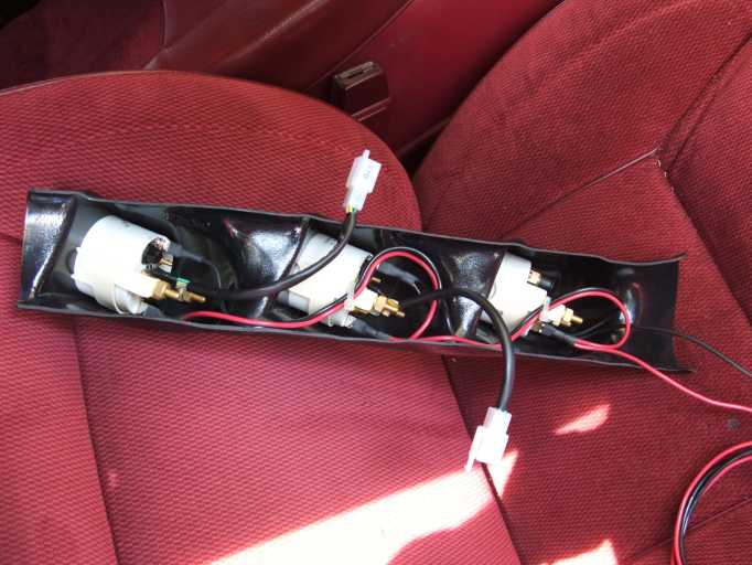

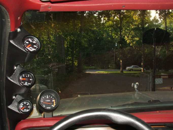

Anyways, I've had the gauges for 3-4 weeks, molded the pillar mount 2 weeks ago, and was ready for some progress on the CTD too! Started about 1100 and finished up about 1700... lighting wired to dash circuit (all crimped + soldered & heatshrink), manifold tapped, & everything connected (gonna put the tranny temp sensor in tomorrow). The sheetmetal screws I bought to secure the pillar mount were 1/4" short (have black plastic "buttons" that snap over them), so I ended up using some with less "visual appeal" ... Test drive netted about 16# of boost tooling around the development!

Nice! Where did you get the gauge pod?

Nice work. Where did u get a triple? just a modified second gen pillar? How did it fit on the moulding, pretty stock fit or not quite? Good work again!

The triple is from JCWhitney (part# in other thread) that took about 1.5-2 hours forming with heat to make work. I fit it very tight on the gauge edge and left a small "gap" on the front side for the wiring... had to grind the corner off the OEM pillar plastic for the bundle to fit thru though.

Sweet looking love the 3 gauge pods looks nice and clean

nice work, I`m diggin the tripple. Try some wd40 and a clay bar on the overspray, it`ll probably come off pretty good.
