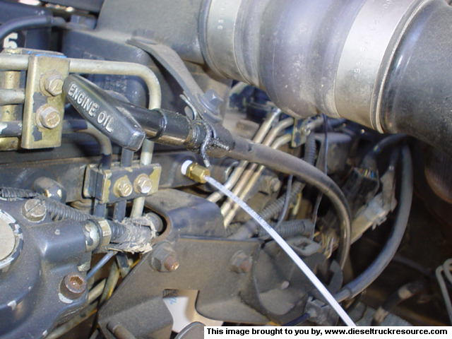

Just good natured ribbing on the Dodge forums. We call the 24 valve guys "overvalved" and they call us "undervalved" (or "faster" ).
A boost bolt replaces one of the intake horn bolts so you don't have to drill the intake horn. We don't need one because Cummins was nice enough to provide us with an 1/8" NPT port in the intake manifold area of the head.
Old May 5, 2007 | 09:14 PM
dieselJon's Avatar
Posts: 1,958
From: Dixon, IL
Is that near the intake horn?
Old May 5, 2007 | 09:30 PM
wannadiesel's Avatar
Posts: 22,594
From: New Holland, PA
Yep. Just below it in the side of the head there's an allen head pipe plug. Here's what it looks like with a boost gauge hooked up.
