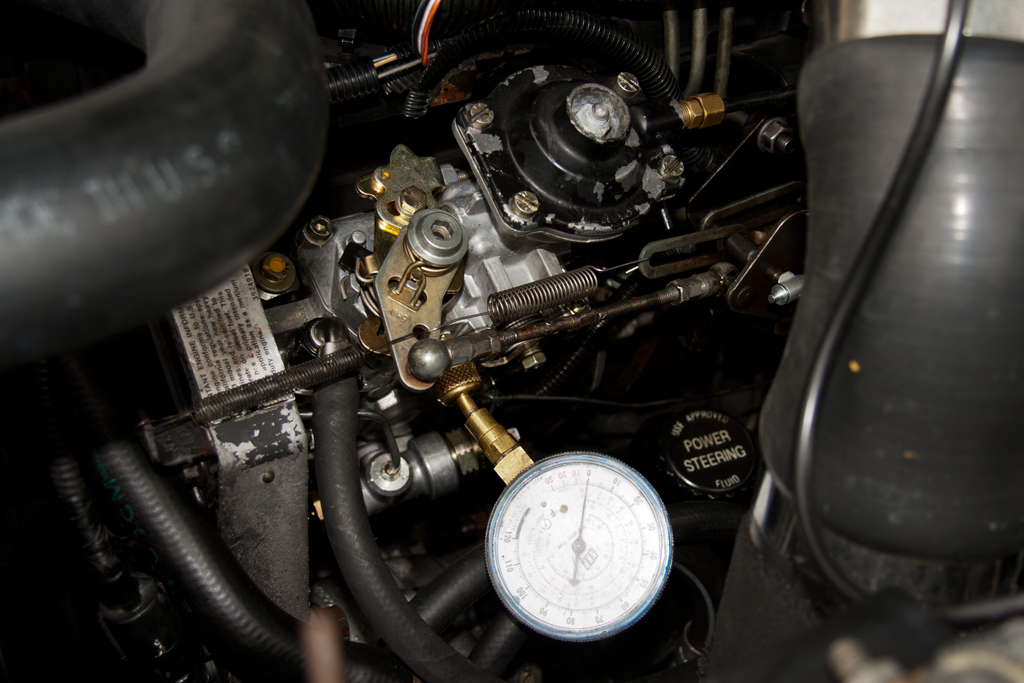

And where is good to tap in to get a case pressure reading? There a better spot than rigging something up with the return? If I remember how the return banjo works one could tap a 1/8 npt in the end of the bolt

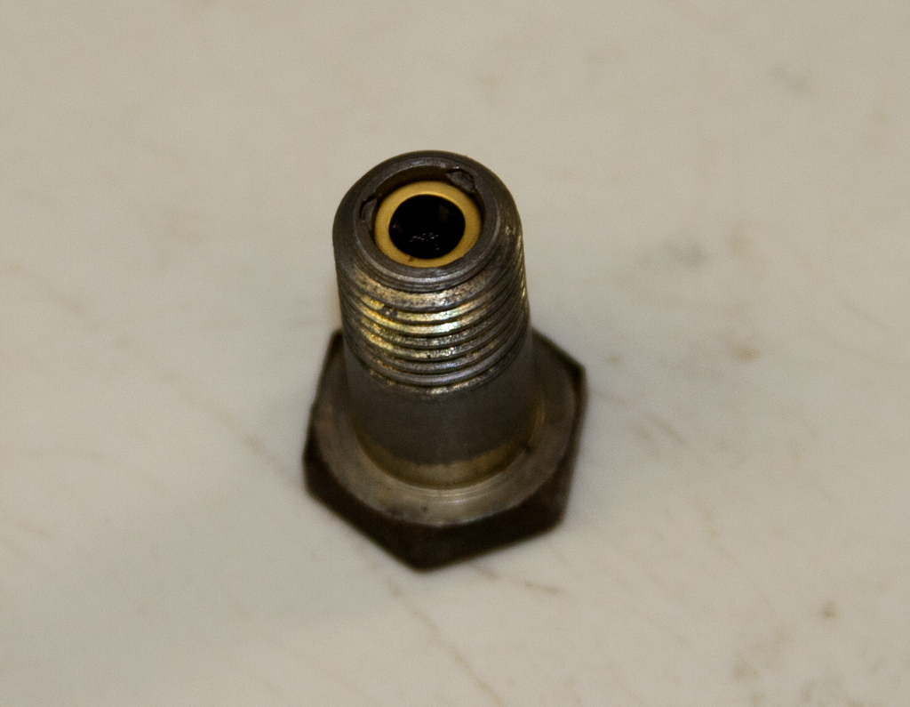

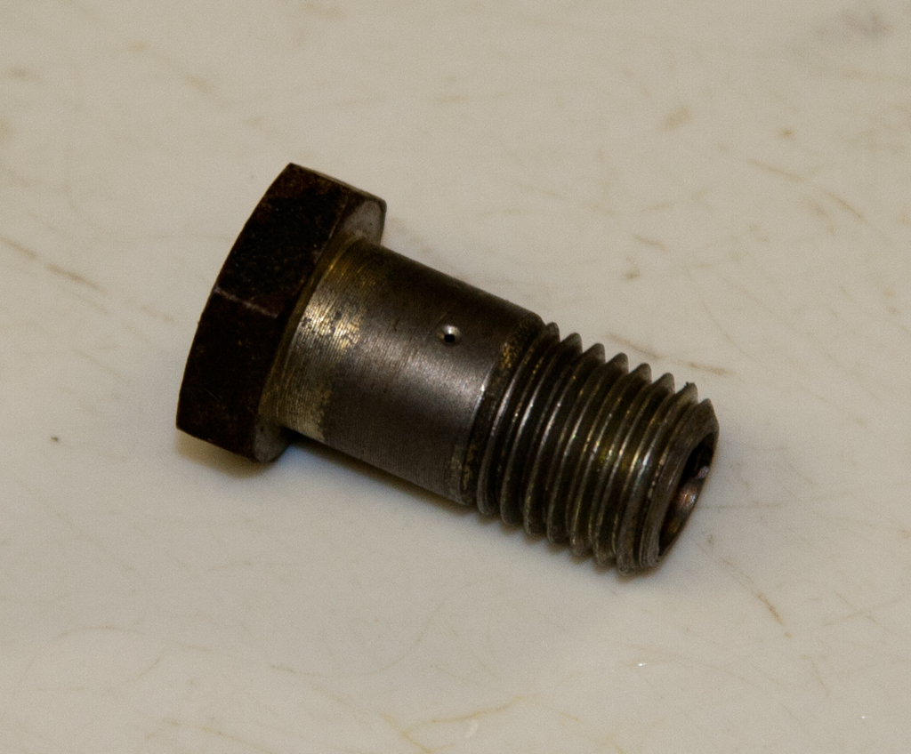

If one has the means, drilling/tapping the bolt-head of the overflow-restriction-bolt thingy will work. Just don't damage the metering orifice in the side of the bolt . . .

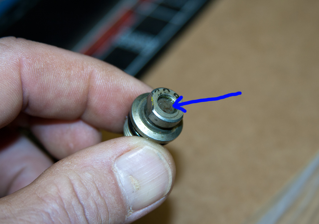

Nor the protective filter-screen inside the bolt . . ..

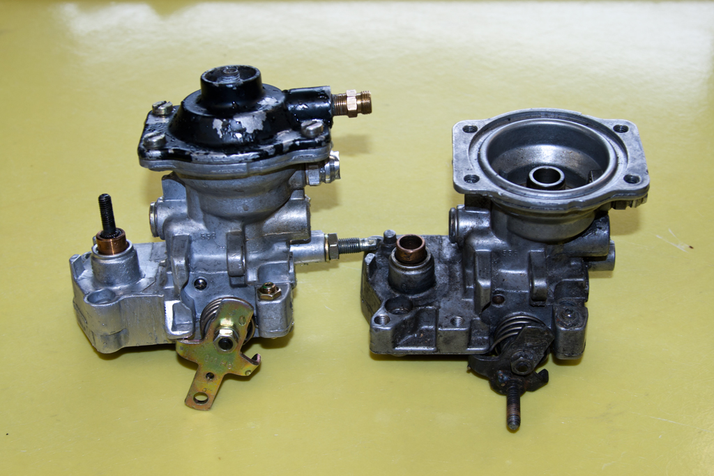

I opted to grind away unneeded metal to make me a spot (altered on left, OEM on right) . . .

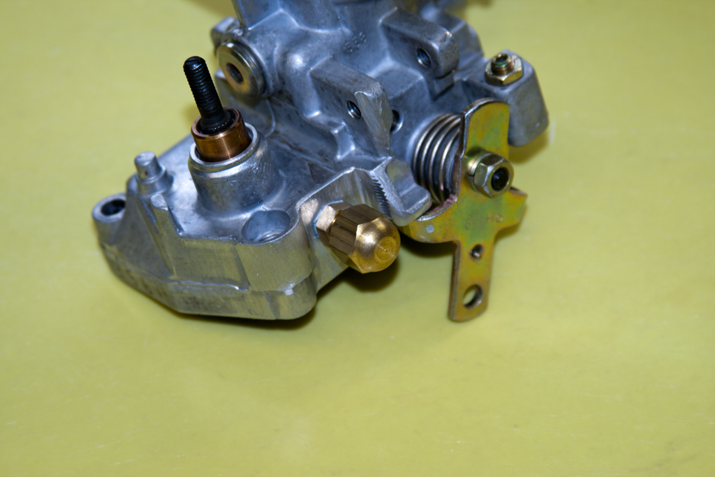

And install an access-port there . . . .
Works like a champ .. . .
