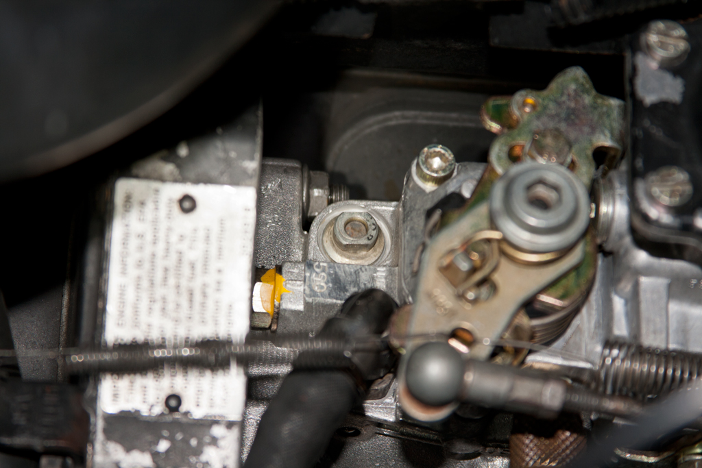

Where exactly is the relief valve located?
Sent from my Galaxy SIII via tapatalk 2
Old Aug 18, 2013 | 12:20 AM
BC847's Avatar
1st Generation Admin
Posts: 4,601
Likes: 118
From: Buies Creek, NC
That shown here does not have the typical KSB plumbing we normally see, but the location's the same.
