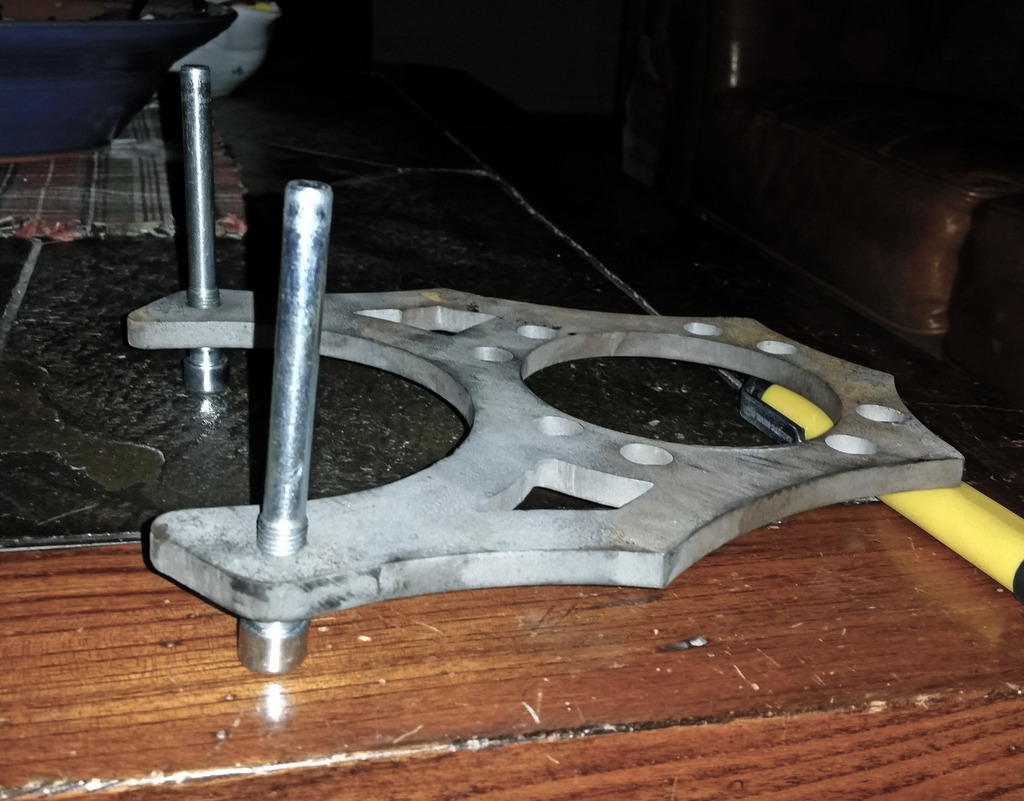

Bought bolt-on brackets years ago, same with Eldo calipers. Recently got the K20 discs, brake hose and e-brake adapters and pads.
I have has a wheel seal leak that was making braking hazardous, and the last straw was the master cylinder leaving the building last week.
Oh, also bought a school bus master with the larger plunger.
Started today taking the old drum stuff off, replacing the seals and putting it back together. Went to thread the caliper bolts onto the brackets and quickly realized something was wrong.
Pulled apart and threaded the bolts in and they were pointing decidedly in any direction but straight.
Looks like they jus ran a tap down through the laser cut holes by hand!
I will be looking for heli-coils that are the right size tomorrow, then drill those out on the drill press and get them fixed.

that sucks! some quality control, imo so do the cad calipers, egr sells new for about 350. and the claim the piston check valve will survive a lot longer, plug dead center on piston causes grief when retracting for pad replacement.

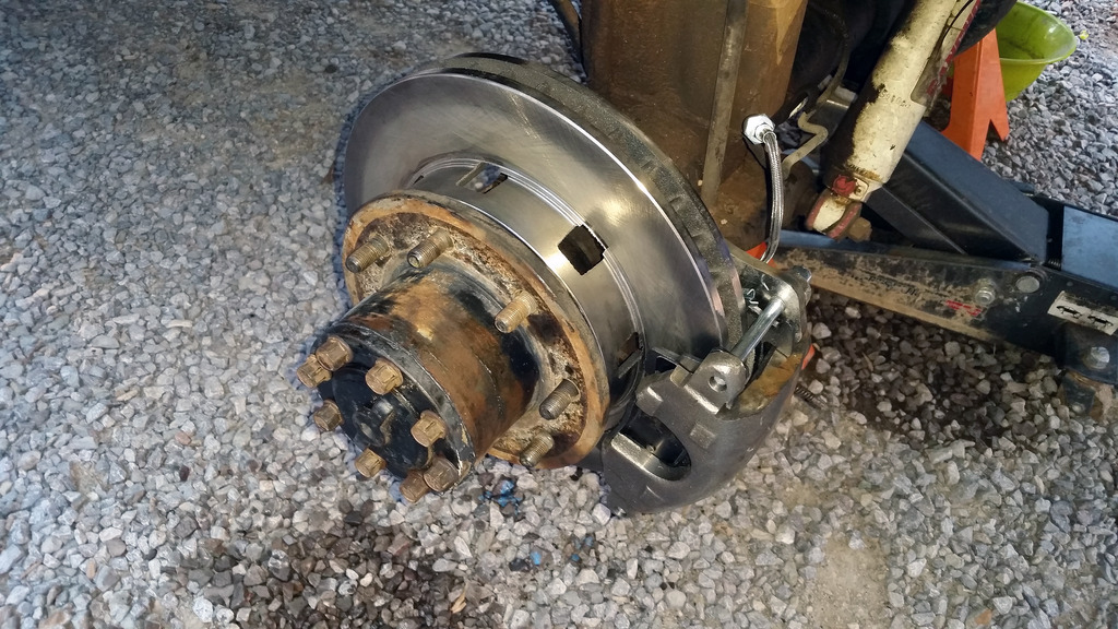

I thought about that, but I wasn't sure if that setup would fit in 16" wheels.
I got everything on, only to be defeated by my school bus master cylinder... bolt spacing is wider than on my Dodge. Everything else is identical (except for the larger piston and bore) so will have the holes elongated with a mill tomorrow.
