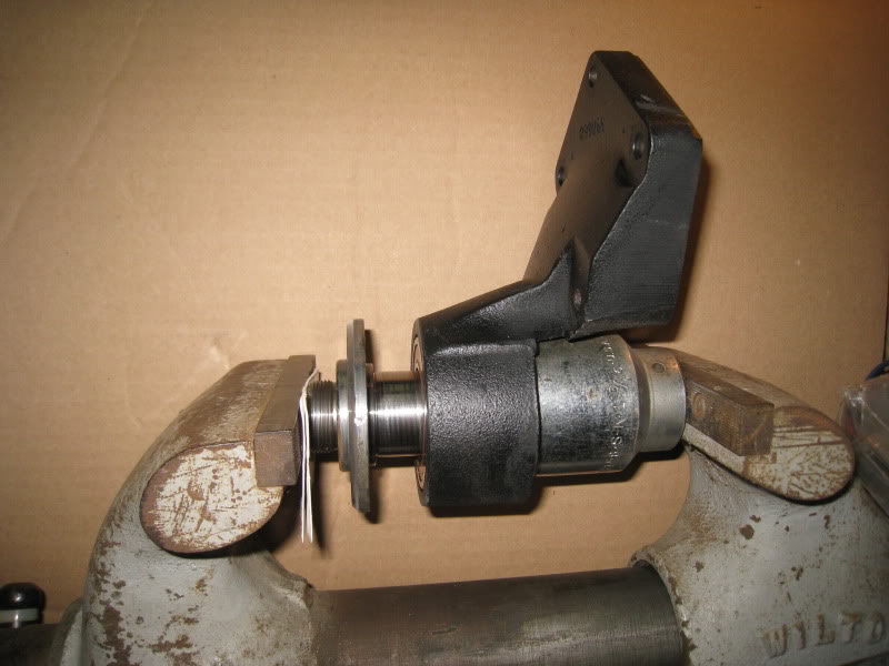

I was able to replace the bearing in the housing using a vise as a press.
Here is how I was able to replace mine, look at post #8
