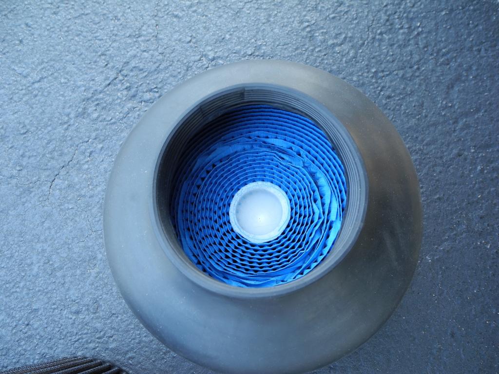

found the source of the problem, i had installed a donaldson powercore air filter on the end of my asa intake and found that under high boost it was pulling the filter against the asa intake tube.

woops! Glad you found the problem!
