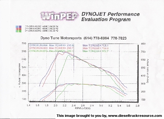

here is the dyno sheet form saturday

you got a sheet from the last time?

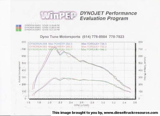

here is the first dyno run sheet
Old Apr 10, 2006 | 06:26 PM
Underpsi's Avatar
Posts: 1,125
From: Ontario, Canada
They look quite simular with minimal differences. Im also wondering the same as Paccool, have you tested the truck on the street again since?

I looked at your sig and the sheet. You've done more on the airflow and on the turbo than I have, but I've done a DTT TC and ValveBody upgrade. My sheet (see my gallery) looks like yours, maybe better on the high end. I think your TC and transmission slippages are doing it to you.
Once you do the trans upgrades, your stats should be far better than mine.
OBTW, this was also a Dynojet and I didn't see full boost, either. Maybe 23. Then again, I never see more than 28#, even towing.
Did you run in direct 1:1 (no overdrive)?
Regards, DBF
