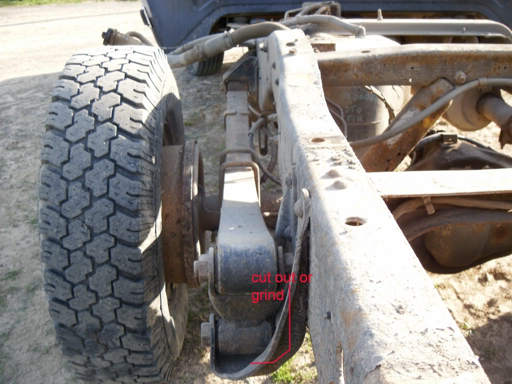

I talked to them and they said their unit would work on a first Gen if you grind the bracket a little. Here is the clearancing info.

thanks for the pic mark. i don't think i'd feel comfortable cutting/grinding part of the hanger and risking a loss of structural integrity. however, looking at all sulastic springs they have, it looks as so i may have no choice than to do just that if i do decide to use the springs.

Here is a better view. The first picture over states the amount of cutting needed....

From the looks of it I think a little clearace grind on their shackle would do the trick.

are those pics from your truck or a 1st gen? do you have more pics of them installed?
Those were sent to me by the company, but they are supposedly 1st gens.
Old Jul 13, 2010 | 02:21 PM
jimbo486's Avatar
Posts: 4,389
Likes: 114
the first pic is definitely a 1st gen. the second pic doesn't quite look like one although the hanger is similar.
