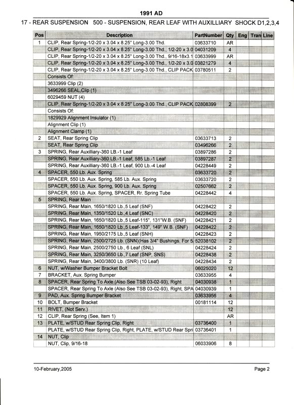

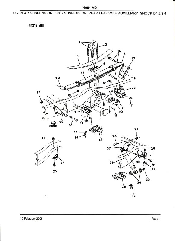

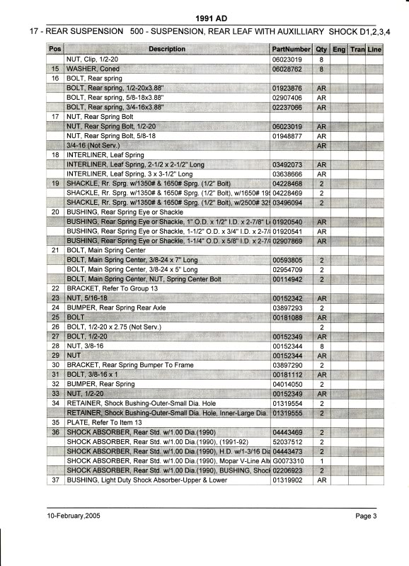

Jimbo,
Here is some information that I have in my collection for Rear Suspension with all of the part numbers and specifications you might find useful, you should be able to figure out what you have under your truck.
I should probably file them in the sticky for future reference.
Hope this is of some use to you.
Jim

Originally Posted by jimbo486
Interesting. I'm looking to improve the ride as everyone else is here but I don't know anyway other than a lighter leaf pack. I'm sure removing the overloads won't help any though.
If you have the room, installing a longer spring would improve your ride, remove too many springs and and you will create a new problem of axle wrap.
Just be lucky you weren't blessed with a 3400/3800 lb 10-leaf pack.
Jim
