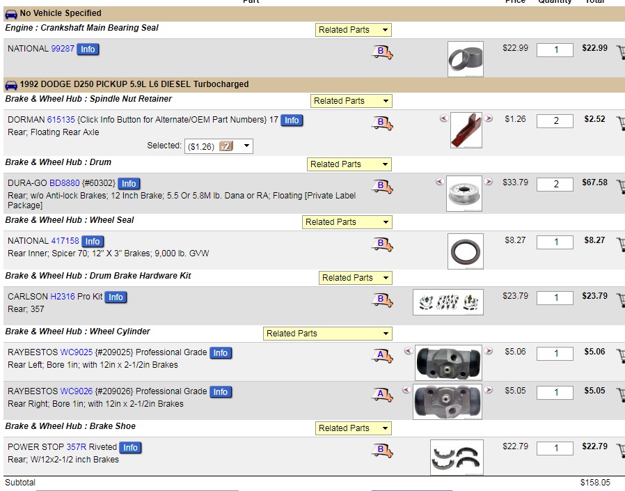

I think I have what I need to fix the axle shaft and rebuild both rear brakes. Attached is a picture of my cart.
I need to add another wheel seal and maybe upgrade the shoes to 3 inch since I have new drums. Only thing is, I am not sure if the 3 inch pads will work will all of the hardware or the wheel cylinders I have in the cart.
There are a few more things i need like the parking brake cable adjuster along the frame needs replacing. maybe brake lines. I will have to look at that later.
They list a lot of different parking brake cables. Does anyone know which one is the correct one for a D250 standard cab? Does the parking brake control both drums are just one? I have not really looked at it that close.

The 3" shoes are bolt on, no problems. There are 3 parking brake cables:
1. from the pedal to the adjuster on the drives side.
2. the long one that goes from the adjuster to the pass side wheel
3. the short one from the adjuster to the drivers side.
Is the pic from rockauto? Are both of the rear brakes gunked up with grease? I ask because there are 2 little metal clips, one on each side, that hold the cable to the actuator arm of the parking brakes. I would call rockauto and make sure that the cables that you buy come with the clips, some do, others don't. I know you don't want to disassemble everything before you have the parts, but yours are in such condition and I would suspect that some things are bad. Also, buy the hardware kits too, the better ones come with all the bits. I have always gotten the correct part from rockauto, because I pick the part...Mark

Yes that is from Rock Auto. That hardware kit in my cart has what appears to be all of the hardware including adjusters and adjuster arms. My plan was to replace it all.
I doubt the other side is like this since there is no oil leak. I am sure the shoes are bad since the front pads were worn out.

I am sure that the shoes are bad, if only from the grease. I don't think those little clips for the p-brake come in the kits. They come with some cables...Mark

If you go to 3" wide shoes then you should have the 1-1/8 bore wheel cylinders.

I updated the cart with 1 1/8 bore wheel cylinders and 12X3 shoes.
Would you get another speedi sleeve for the other side or a unitized seal or regular seal? It is not leaking right now.
