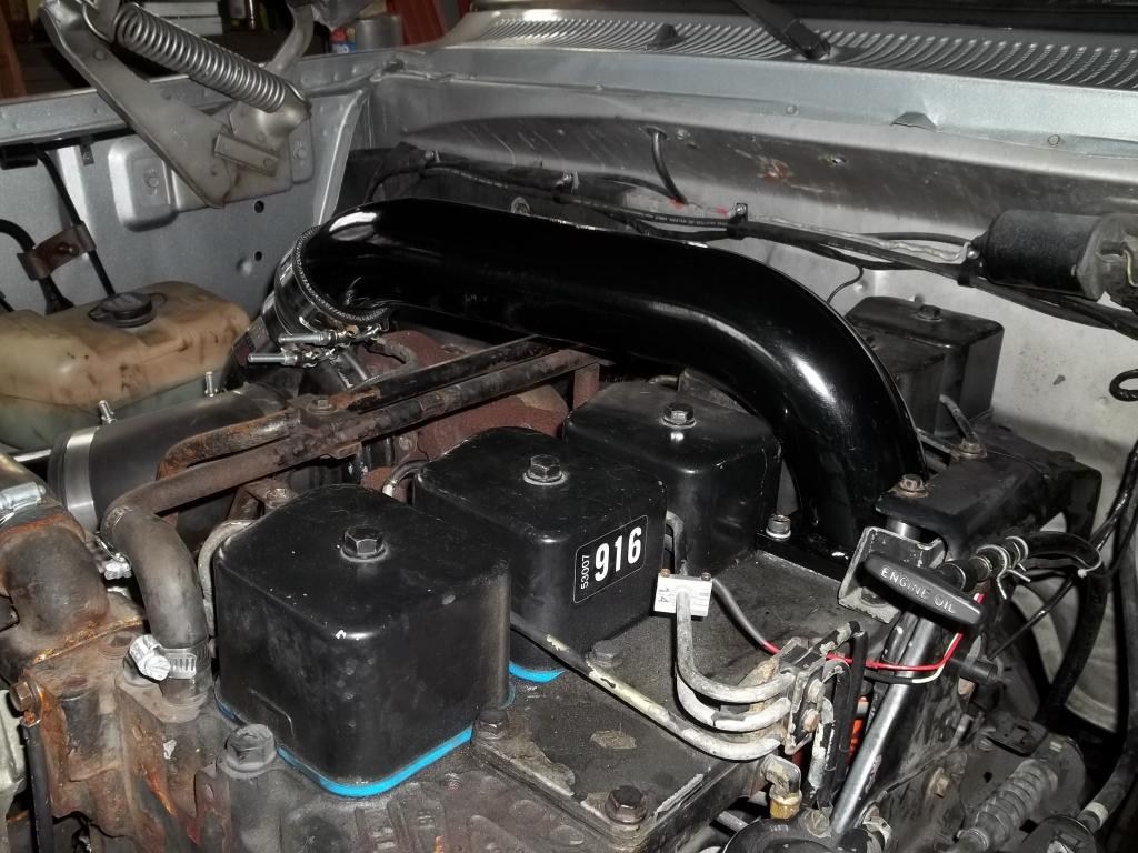

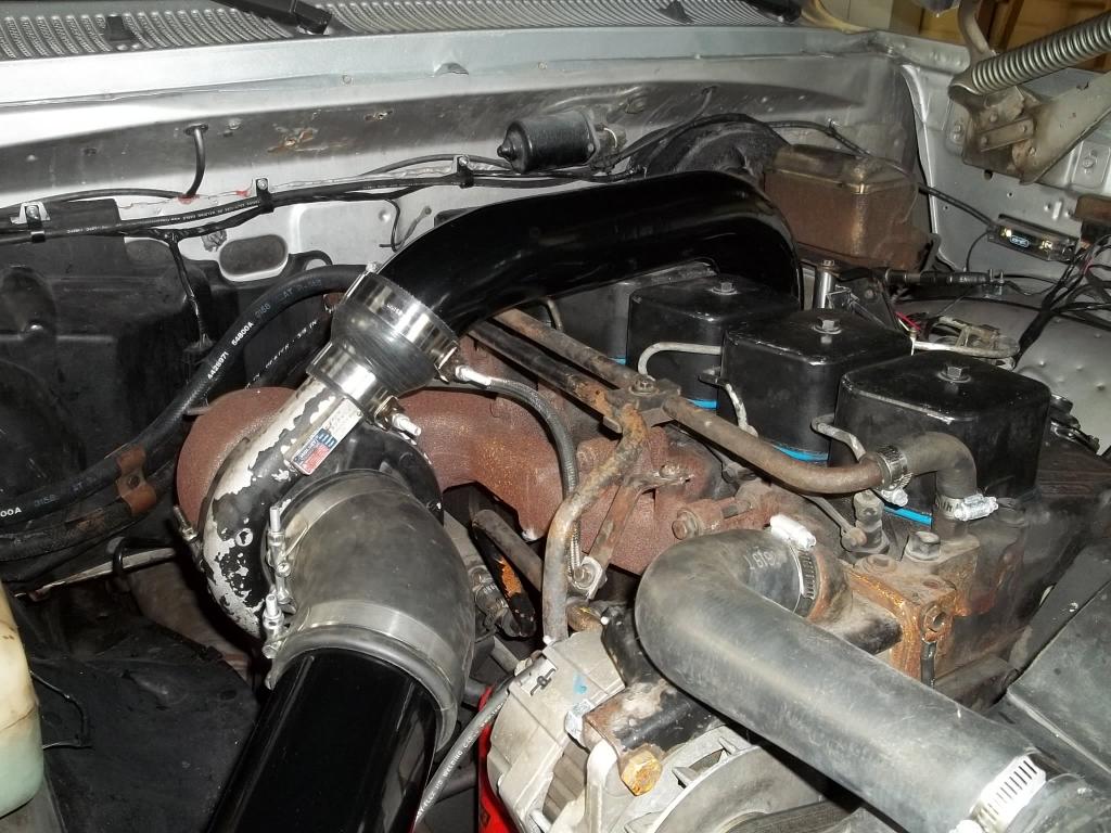

sure looks like tims.notice it's back ordered!talked to tim about making one and we just couldn't get togeather.i ended up making one with out using the grid heater.it's off being powder coated,so I can't get a picture until it comes back next week.

put on my new crossover tube today.
