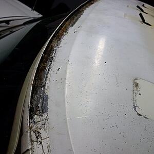

Had to remove the HD bush front bumper to squeeze patches into the garage....and still not much room...but I'm tearing out all the drip rail sealant and redoing it all again. I redid it about 4-5 years ago? and it was worse then ever.
Still not going to be able to do it properly due to time constraints and room, but will get it good enough for now. Once I have a shop built I will pull patches for a month or so over the winter and redo it AGAIN. This time media blast the drip rails, weld up the existing holes from rust and try some of that good 2 part self leveling drip rail seam sealer etc.

Yesterday go the drip rails cleaned out....man that sucks getting the seam sealer out...heat gun is a must! Then a couple screw drivers and a pick or two.

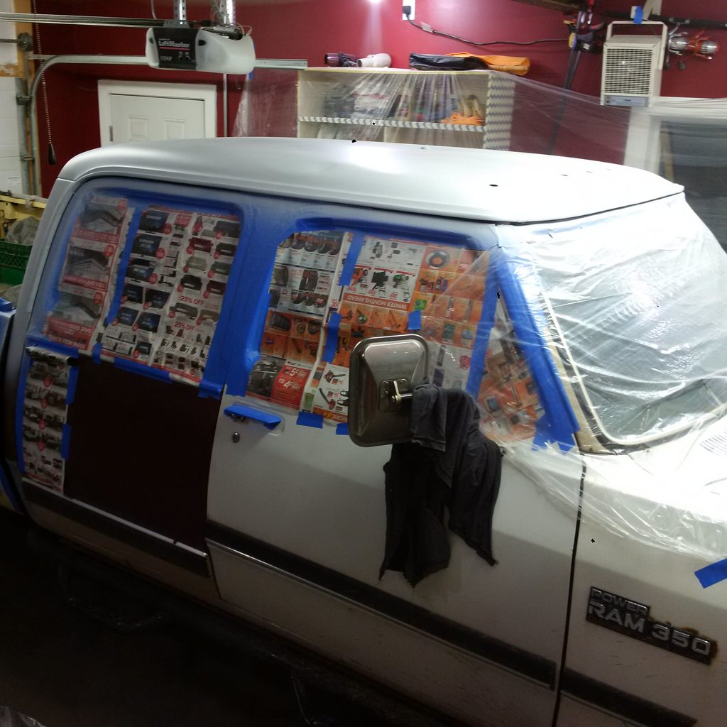

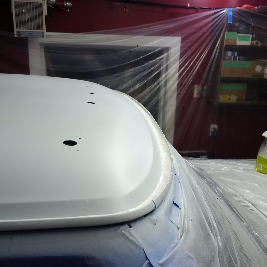

Once cleaned out then some wire wheeling to clean things up as best I could. Then I put on a couple coats of a rust inhibitor primer with a small brush so as to get into all the nooks and crannies.
Once all that was dry I masked the truck up and then sprayed on 3 coats of primer....one full quart.

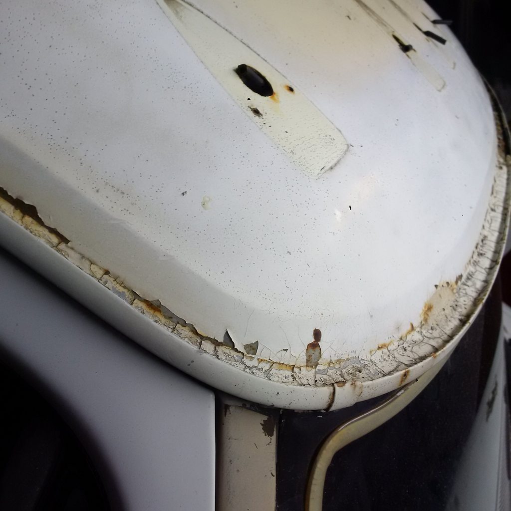

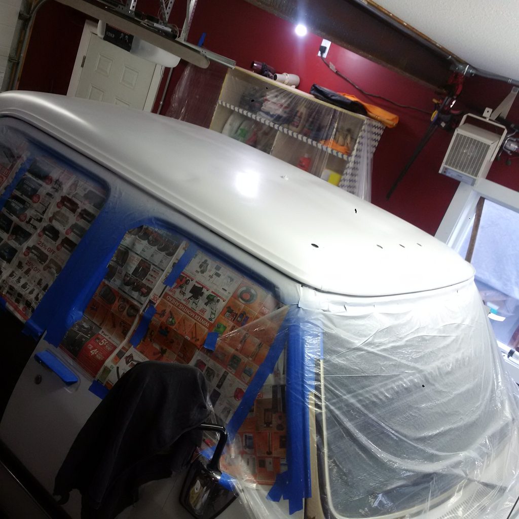

Today I put the seam sealer on.....man I forgot how much that job sucks! Now I see why the have self leveling sealers...worth the extra money IMO. Now I am just waiting for the seam sealer to dry a bit more and will toss on some white lacquer paint. It says you can paint after 30 min....but I want to give it a few hours to set up and dry.
Will let it sit and dry tomorrow and then get it back on the road.
And painted...

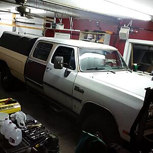

How about some shoehorn in it's garage photos of Patches ?
Old Nov 12, 2017 | 02:24 PM
  #1314
I have been taking pics, and signed up with Imgur...just no time right now to upload and post pics. I will though.
