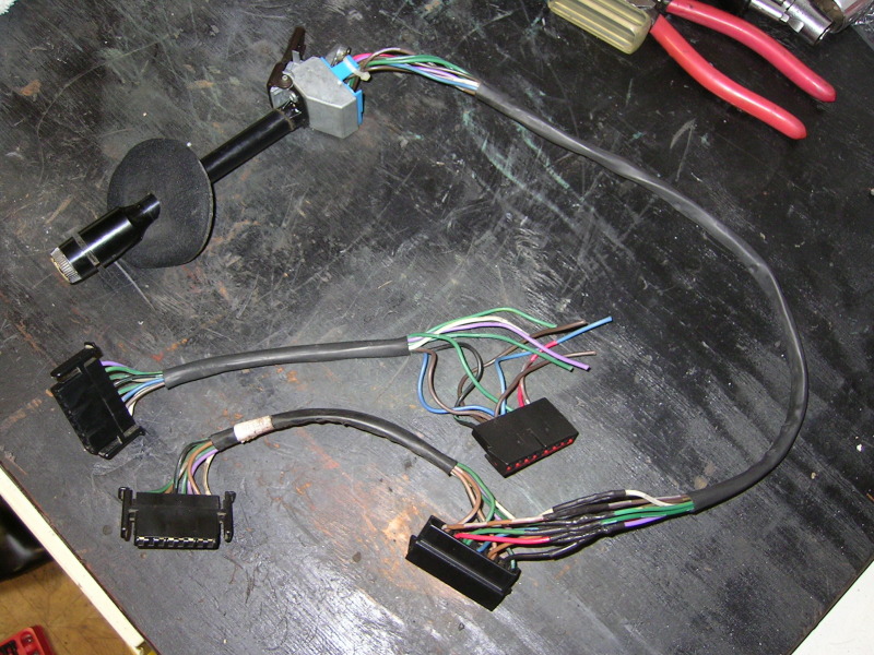

Dead wipers
My wipers quite last week on my crewcab...89 wiring. But my problem was in the wiper control on the turn signal stock. It's been rattling, and making odd clicking sounds, and would wipe erraticly, been like this for a couple years now. I knew it would die eventually, but never took any steps to prevent it either.
I have a spare steering column, from a 90/91, with the same wiper control. So I figured I'd use that. Swapped it out yesterday ....and nothing!! I thought maybe it was the wiper motor. So I pulled the motor and tested it...no problems there. So I pulled the new'er stuff back out and compared the old vs the new. Turns out the wiring for the 90/91 is a bit different. Plugs are the same, actual control stock is exactly the same...save for a couple wire that are a different color...but the whole wiring system is set up differently.
Last night I decided to cut and paste my two systems. Use the new'er control stock, and the old wiring. Carefully made sure to match all the wires to the proper connections, and solderd them all together. Will try installing it this morning...hope for the best.
Old Jan 6, 2013 | 11:07 PM
  #58
Well here is a pic of the joining of the two harnesses....
I installed it, as I said earlier, and nothing worked. But you could hear the intermittent relay cycling, and power clicking into the system. SO I pulled the wiring out again and double checked my connections....yup everything was exactly how it should be. So after that I re-install the wiring and decided to check the plug at the wiper motor. I was getting power to the plug, from different location depending on if it was intermittent wipe or not. And the washer fluid pump was working...so I figured it had to be the wiper motor.
So even though I had pulled the motor last night and it cycled fine, I decided to use a spare motor I had. Although this one had a different wiring connector so i couldn't plug it in...but I had snagged 6" of wiring with it so I was able to make a jump to the wiring in the truck. And if your doing this don't forget the external ground. So i hook everything up, power it up and the motor works perfectly. So this was the problem.
So onto Rockauto to find an interchange list...then out to the wreckers...grabbed an almost new one from a 91 Plymouth Voyager. Came home and hooked it up first off with the jump wires...and everything worked!! SO out came the old motor...then swap over the new motor onto the base plate from the truck, then re-install. I now have wiper again!!

Way to go! The motor must have just had an open circuit inside huh?
