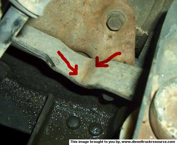

When I had my truck apart I found a huge crack on the top of my frame rail in front of the steering box, and I can't decide the best way to fix it...
Any ideas?

Just as an example of what Mark's talking about. The camera's looking through where the radiator would normally sit, and that's the steering box mounting plate in the background. ~
