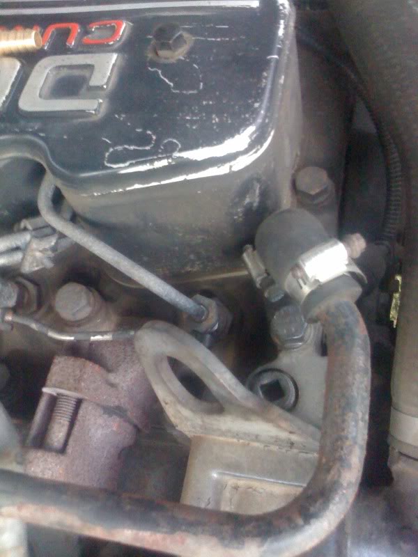

just wondering if anyone knows if there are multiple "coolant out" ports from the engine block?
here is a pick of the coolant line but wondering if either of the other two ports are coolant? and if so does anyone know the thread size?

That pipe plug on the T-stat housing is a coolant port, there are a few more around the head, particularly under the intake side. I think there are two under there. I seem to remember that they're all 3/4" MPT.

i could be wrong but the one on the top pictured here seems a lot smaller then a 3/4".
either way anything wrong with tapping into it?

It is tapped for a 1/2" pipe thread.

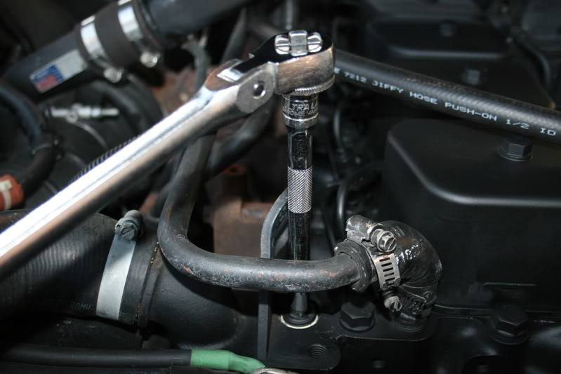

https://www.dieseltruckresource.com/....html?t=209772
Jim

Funny thing is I wrote 1/2" first but the pic fooled me into thinking it looked larger than what I remembered. At any rate, a standard pipe plug will seal the hole.
