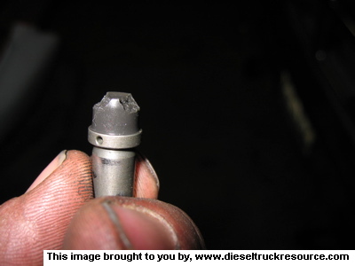

heres the pics i tried linking to.
Old Apr 7, 2006 | 05:48 PM
wannadiesel's Avatar
Posts: 22,594
From: New Holland, PA
That's really bad! How long was that plunger in the truck after you noticed it wouldn't shut off? Mine only lost one chunk about half the size of what's gone on each side of yours, but I pulled it as soon as it stopped working.
Old Apr 7, 2006 | 05:54 PM
swank's Avatar
Joined: Apr 2003
Posts: 626
From: idaho
would you believe.................a long time?
Old Apr 7, 2006 | 06:36 PM
Posts: 22,594
Yes I would.
Old Apr 7, 2006 | 10:55 PM
Jethrro's Avatar
Joined: Apr 2005
Posts: 152
From: Eugene Or.
The funny thing I don't get Is all that rubber has got to go somewhere. Has any one found where ith goes or is the cummins rubberdiesel friendly as well. Jethrro
Old Apr 7, 2006 | 10:59 PM
swank's Avatar
Joined: Apr 2003
Posts: 626
From: idaho
i wondered that for a while too. the only thing i could come up with was that rubber doesn't do too well at 3600 psi. and i'm guessing those chunks didn't come off as whole pieces. the last one i took out was about like dave was saying.
