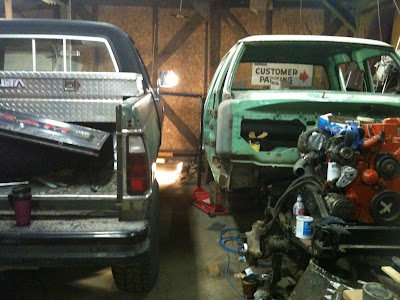

Instead of body lift move the frame mount's up ?
I had that thought as well, but I an sick of cutting out rivets and that would be 16 more.

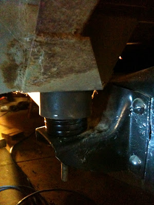

Look over where the cab mounts down. Check it closely for cracks. I have had to repair many CC's of that vintage that the mounts had broken out of the cab.
Are you talking about the cab or frame. I did have to repair the frame. You can see the washers I welded on in the pics. I have not checked the bottom of the cab, Thanks.

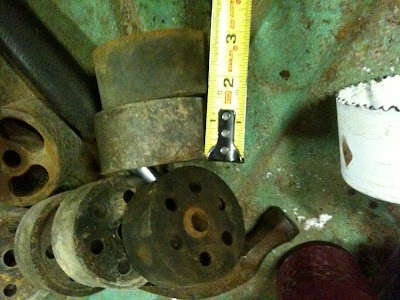

after mulling this over the last few days, I realized I had a 1.5 inch body lift in my cummins ramcharger and it did not need to be there any more because I performed surgery on the back of the front fenders last summer. It als just so happens that I pulled the rc into the shop yesterday and yanked the dana 60 out of the front to swap the 3:54s for 4:10s. Sooooo, today i pulled all the body mount bolts, loosened up the adjuster on the tranny shifter and slipped the spacers out from under it. I put them under the crew cab and the clearance over the fuel tank is perfect. Thanks all for your advice and help. This was easy and free.
I just hope I remember the body is not attached to the frame on my rc before I test drive the new gears.
