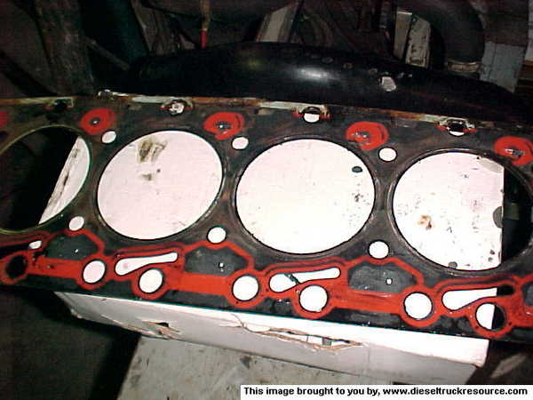

All cleaned up, bores look good, no scoring, no melted pistons. Still looking at crosshatch at 268,000 miles.
Blown in 3 spots on the passenger side into the water jacket. I did manage to seal it up last year and keep going with it. Like twice out to Fall Brawl and Spring Fling out in Dillsburg, PA, towed out with it and trailered it back, numerous sled pulls, hauling, daily driving.
Close up of the mess.

I examined the head gasket again a little closer and #4 was blown to the outside, there was carbon on the gasket surface that the head does not sit on.
