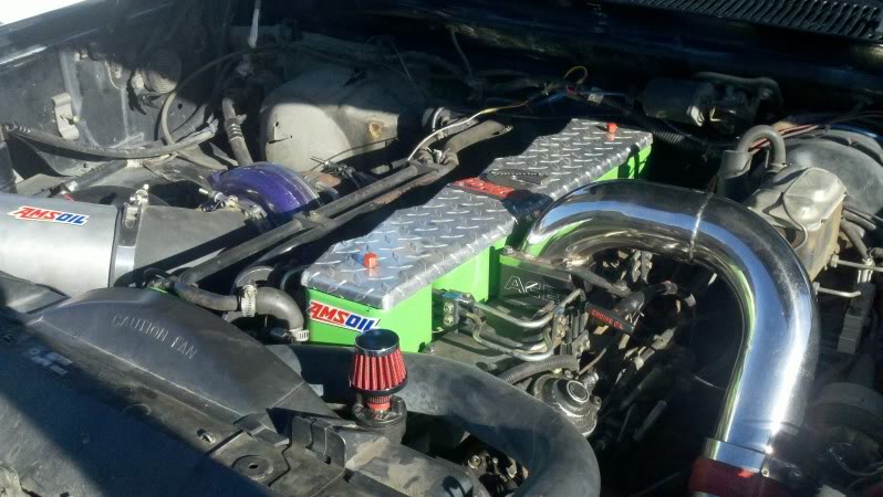

I've heard good and bad about the 24 valve crank case breathers and couldn't find one so I ran down to Autozone the other day and got a little spectre breather, a 3/8" hose barb and some epoxy. Drilled a hole in the middle of my oil fill cap and cut the handle to fit the hose barb and epoxied it in there, then slid the breather on and clamped it.
Hopefully it will help a little, I haven't driven it much since I put it on but with the engine running or when it shuts off I can see a slight haze coming out of the breather so it must be working... and its not soaked with oil... yet. Oh well for under $20 I figured it was worth trying for now, but I've priced out the dual valve cover breathers and can get the whole setup from a case dealer for about $130ish so if I want two dual covers its gonna be $260ish... I'm gonna see how well this works but I may go with the dual covers too in the long run since i plan on twins in the near future.
Are the dual covers worth the money? I've heard they are the best way to go to keep things breathing and clean.
