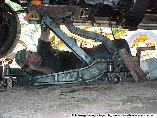

It took 170psi of air to lift the front of the truck with that jack, I had to raise it more to get the trans out on the jack. I think I raised it more than a foot.
I've done it with the np205 attached, that thing is heavy, all it wants to do is drag the trans off the jack if you don't strap it down right.
I would use 2 hydraulic jacks and a bunch of cribbing, you're probably going to have to jack it up 2 or 3 time and set cribbing under the wheels and then crib the jacks up. The angle won't really be a problem, the trans jack will accommodate that. The first time is always a challenge, but after you done a few of them you get better that it. The smoother and leveler the surface you're working on the easier it will be.

. . . I see those cinder blocks under the front tires there.
That jack up front there looks a bit wimpy don't you think? The trans jack a bit flimsy. Where are you working, a locomotive foundry?

Yes, yes those are cinder blocks. You can't really see it, but there isn't alot of weight on the front end, plus there are jack stands under there too, plus the jack has positive locks.
The tag on the trans jack says 1000lb capacity, I think they underrated it slightly. I was working outside our shop at that time, now I work in the shop on a concrete floor or up on the lift. I borrowed a tall trans jack the last time, what a difference, started at 7pm and had the new trans and transfer case in by 1:30am, this included switching parts and a tear down on the old unit to determine the failure.
