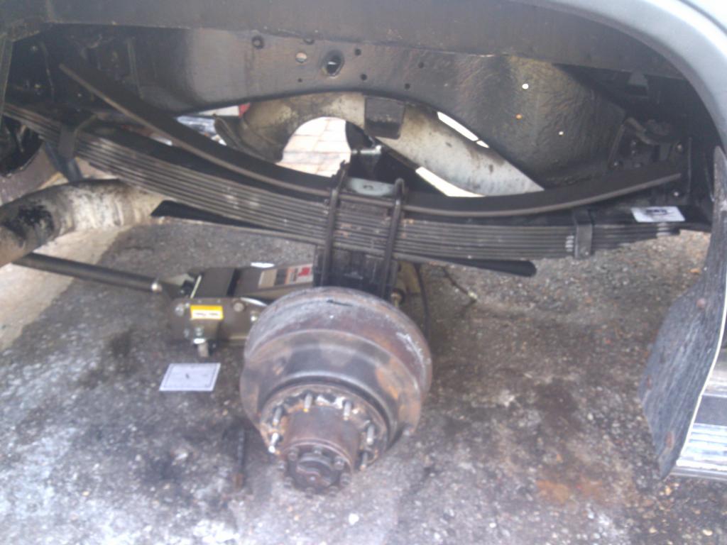

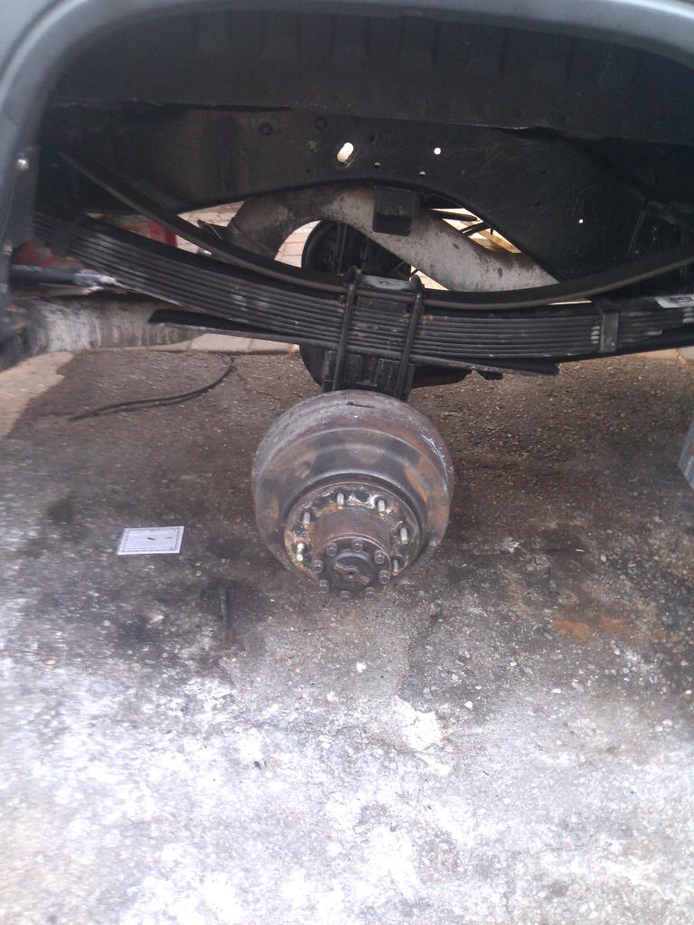

Test fitting the new springs
all done, and sat overnight before torquing so they would be slightly pressurized by gravity.. The 9/16 U Bolts are torqued to 110 Ft Lbs, and the spring bolts (3/4 x 16) are torqued to 135 ft lbs as per the FSM.

I had to lower the mount for the rear brake hose, as the new hose was just a little too tight for my liking. It most likely would have been fine, but I didn't quite like the idea that if I overstretched the hose, I would have been really mad at myself. 5 minutes of drilling a new mounting hole, and it was done...

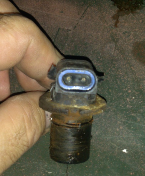

Here was the broken Rear Wheel Abs Sensor that I snapped off. Put the new one it, but I haven't gotten a new wire as of yet. I guess I'll just have to drive around with the brake lights on until I find a new wire

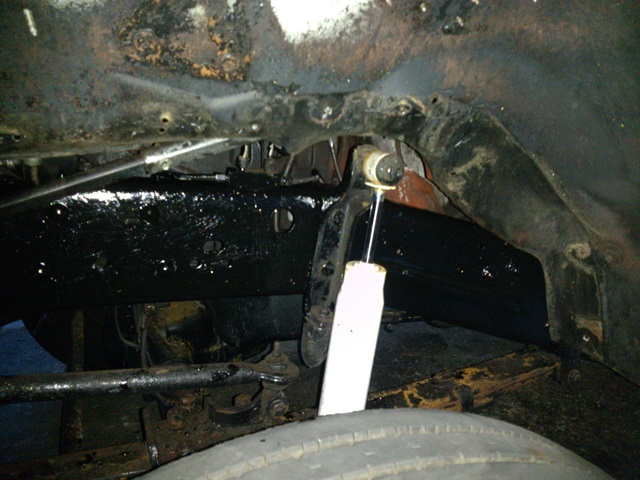

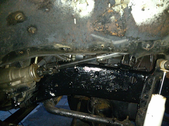

Finally got some time to continue this sucky process I've been doing with the epoxy on the frame of my pig.
Today, I removed my steering shaft shroud, cleaned the frame, and finished the epoxy install on the drivers side. Had to remove the plow bracket, as it was in need of rust treatment and epoxy covering behind it.
