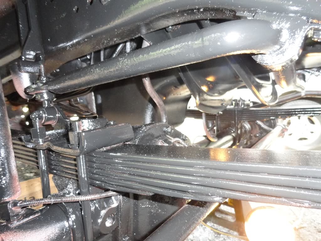

First thing was done was the truck underbody was sprayed a couple weeks ago with a degreaser, then powerwashed. The plugs in the body were removed, and the sediment was flushed out. I let a couple weeks go by to ensure it was dry under there, and then began my quest for a protected (somewhat) vehicle I can drive around in the winter...after all that what it was originally designed for, right ?
I first scraped, sanded, and wire brushed the truck from the front bumper (removed) to the fuel tank. After blowing all the dust off....I applied a rust converter to the frame using a pump sprayer. I'm using a phosphoric acid (PA) to restore the metal and stop the rust. I decided to use this because it's able to be flushed into areas (such as body cavities) where you can't scrape or brush. I pumped the stuff into the crevices between the frame connections, and just about everywhere else rust could possibly form. You let the stuff sit for a day, go back and see what you've found. If the metal has turned completely black where there was rust, you're done. If it's still rosy or red, then a second application is necessary. It's not necessary to remove the converter once it's done drying, but a wipe down is still recommended. You'll be amazed at the difference between the old rust and the new. If it gets wet, a white haze will appear, but if you re-apply the PA and wipe it down. Once it's dry, you're ready to prime. this section required a second application

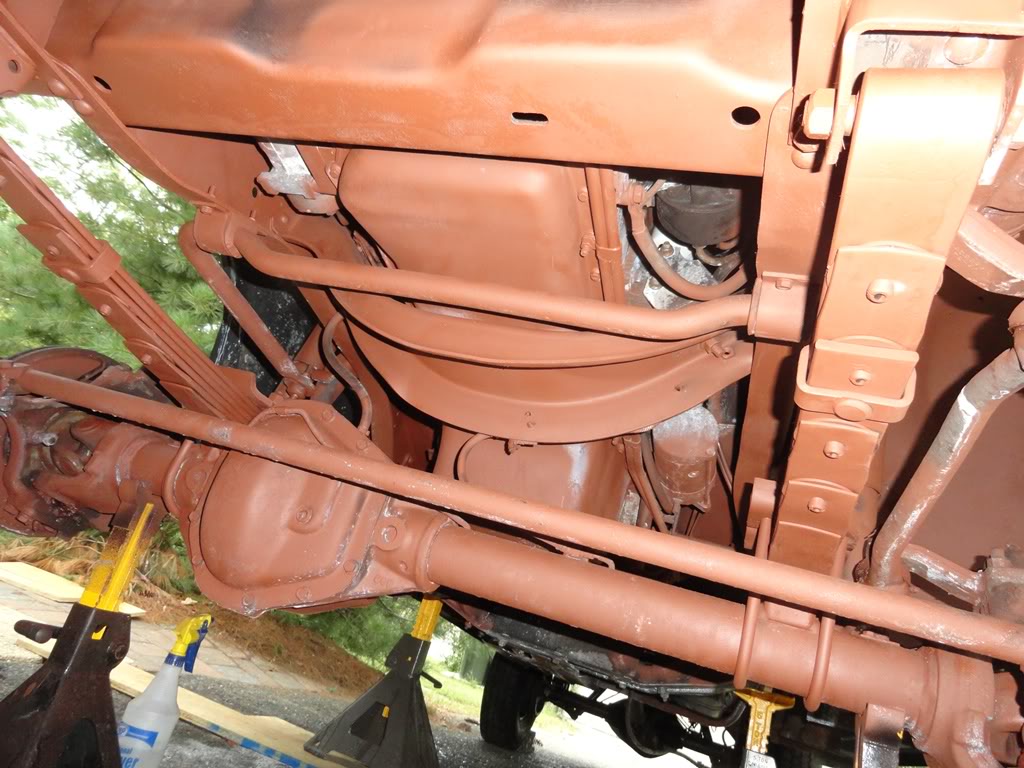

Once it was dry, an oil based rust preventing primer was applied. Although the rust converter claimed to be "self priming", I felt better adding this additional step.

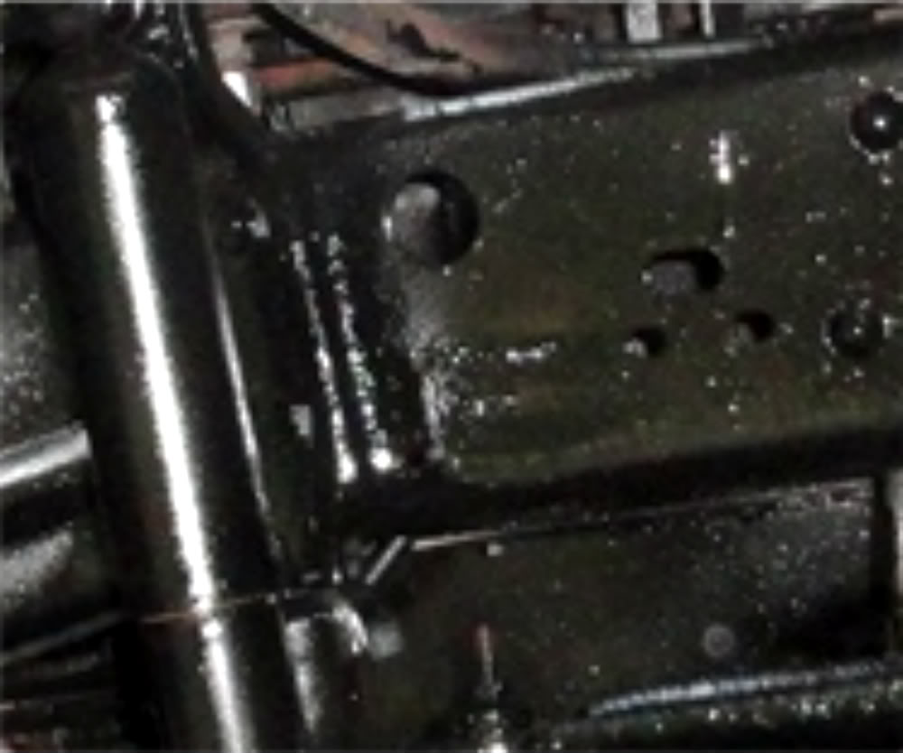

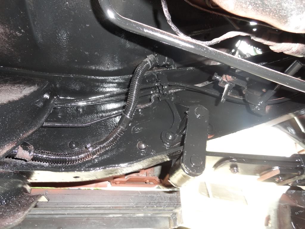

24 hours later.... it was painted with a gloss black paint to protect the new surfaces

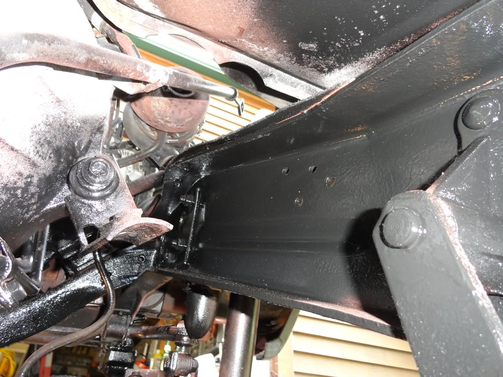

You tend to miss a few spots in the front because of suspension parts being in the way, but after a few tries, you can get paint onto just about every surface.... including the new front springs I just installed.

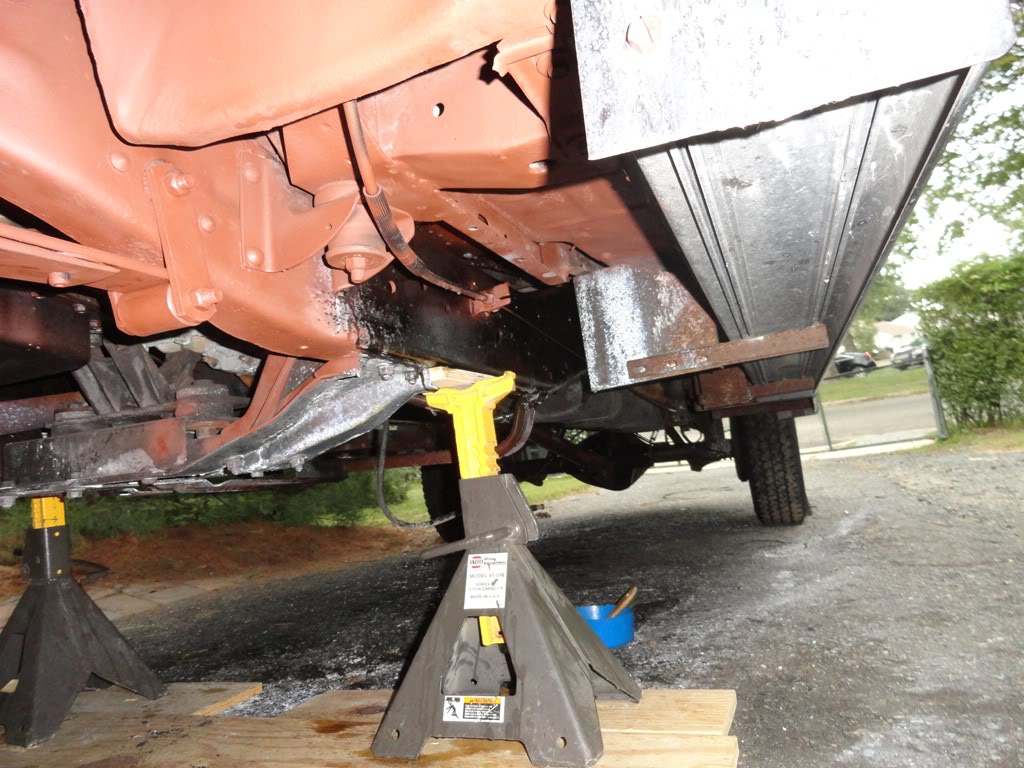

From the cab mounts back, it gets a whole lot easier, as there isn't as many parts to work around... Dropping the fuel tank will require the most amount of work from this point on....and it's really not that difficult....

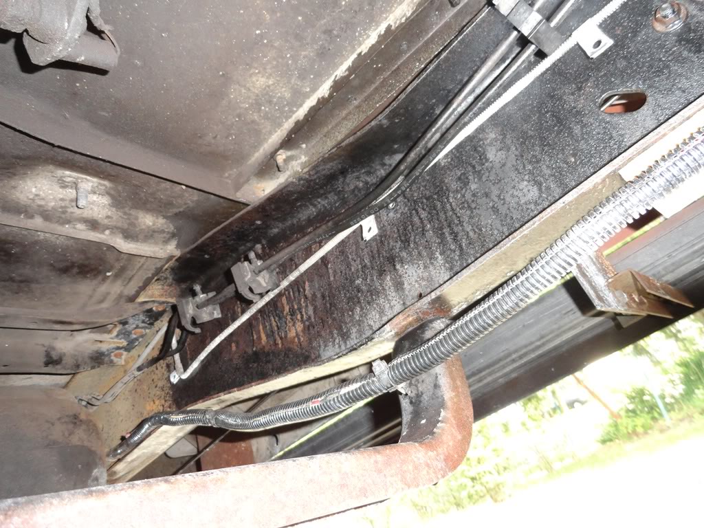

BTW.... removal of the exhaust will be required to get into the frame on the passenger side. Since I had to remove it anyway, the timing couldn't have been better
And make sure you check the tops and upper side of the c-channel, as it's easy to miss spots.... I went back over these after looking at these pix It's essential to not use a primer that's the same color as the chassis, so you can see where you missed.

NJTman,All I can say is I bet you were one grimey dude when you finally got it all wire-brushed.
I like to see such enthusiasm in a project.
It will have to be better even than when new, as the factory intends them to rust and you don't.
At any point, did you consider sand-blasting ??
Good job.
That looks like the Rustoleum primer. Stuff sticks to everything. But you can't use anything else over the top of it but Rustoleum.
I use the rust converter from Eastwood. Expensive, but does a better jog over all. I used to use phosphoric acid, but this is a 1 step and you paint right over it too. I restore Mopars. Fortunately I have a newer truck, but I have already sprayed the bottom. Holds up bare too.
