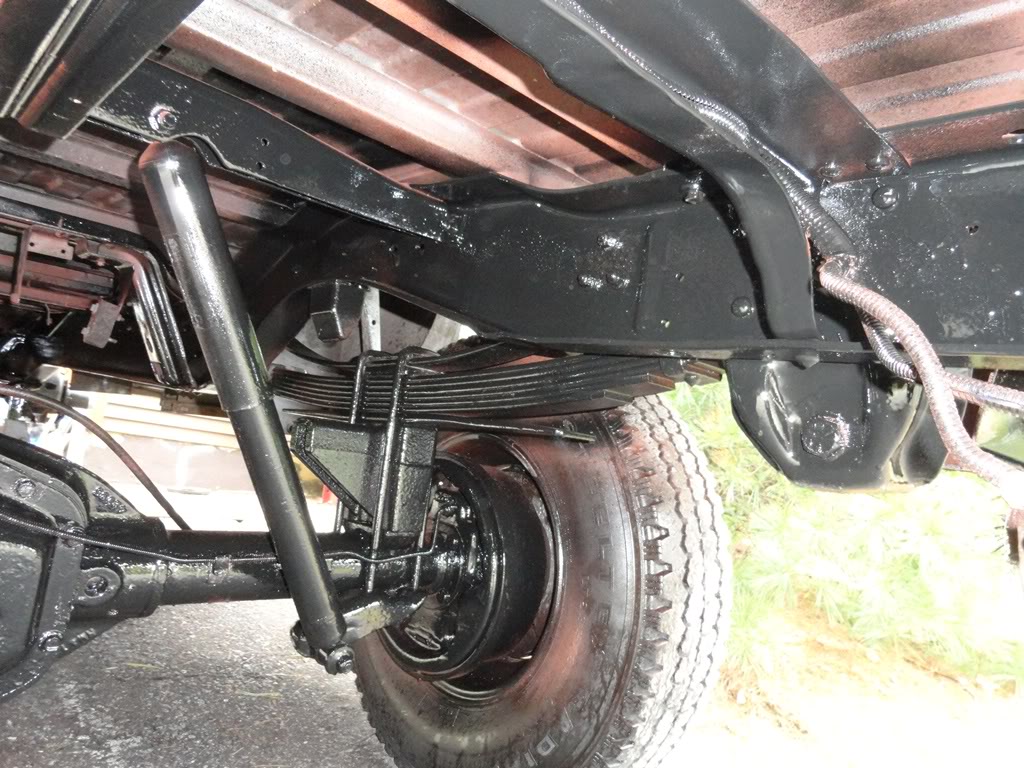

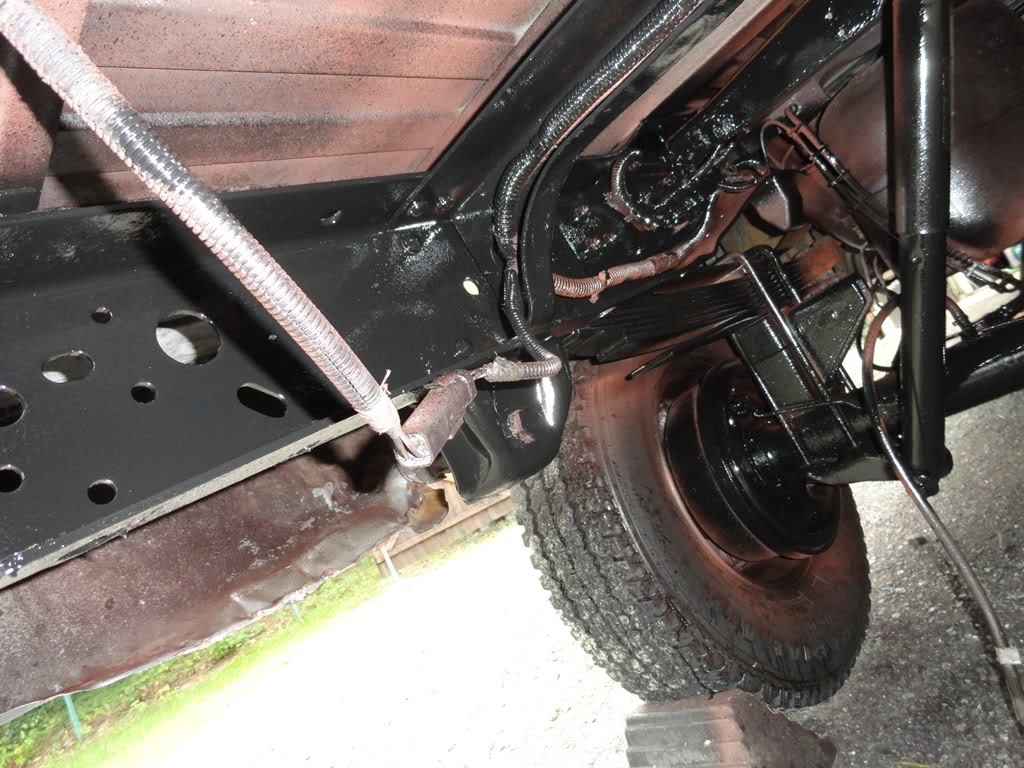

Waiting on parts to finish it.
Rear drivers side frame
Rear passenger side frame
Need to do some touchups before calling it finished ..... for this year.

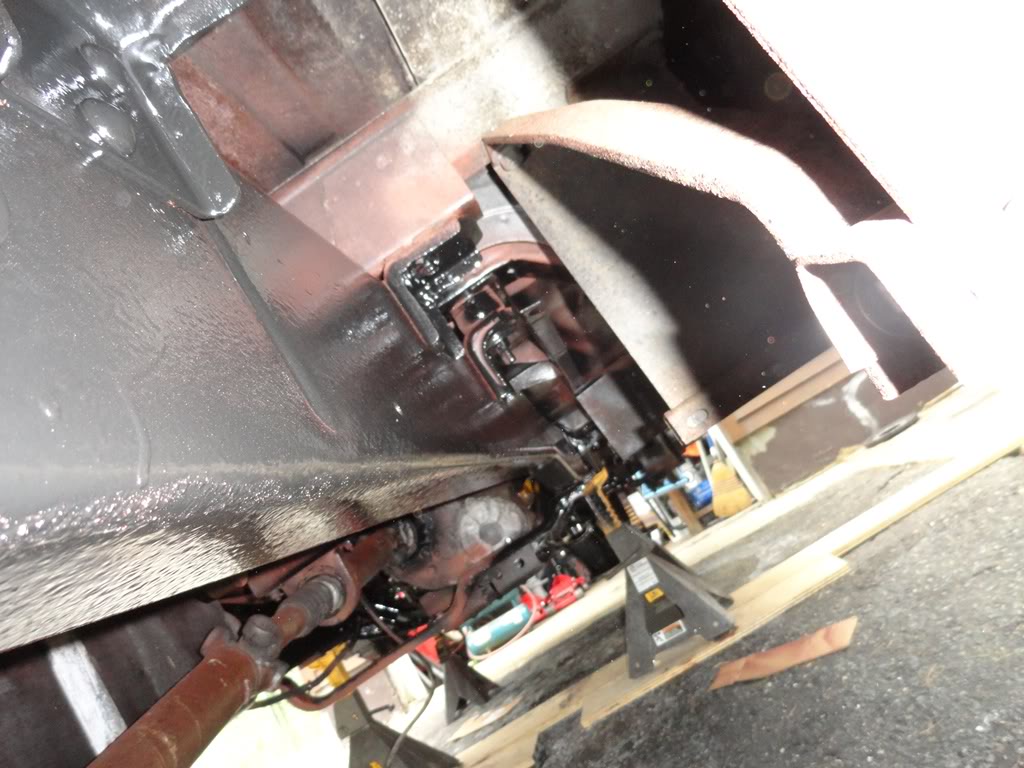

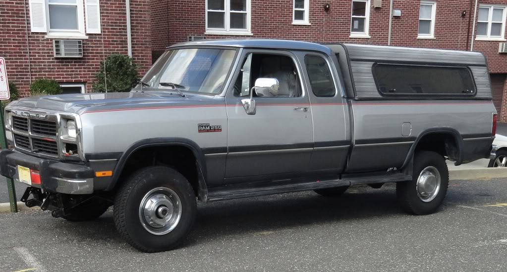

Here's the truck with a new front suspension setup in it. I ordered new springs and had them add leaf glides in between each leaf, and two inches in increased height. The entire frame has been derusted, primed and coated. Today I removed the fuel tank and it was full of leaves behind there. Cleaned it all out, and applied the rust converter to it. Pictures came out blurry, so I won't post them.
Installed a new fuel sending unit and installed new u-joints in the rear driveshaft, including a new carrier bearing. The carrier was bad, so it was time for replacement, including the new joints.
Prime and paint behind the fuel tank tomorrow, and after a few days of drying, I'll put it all back together.
Can't tell you how much better this truck rides and handled, especially since I replaced those frame bushings. Truly amazed at the difference from the original springs. Night and day!
Again, Thank you Jim Lane for the thread about improving your ride. You were dead on, and those glides made a world of difference in how the truck rides. Great advice, well taken and appreciated.
