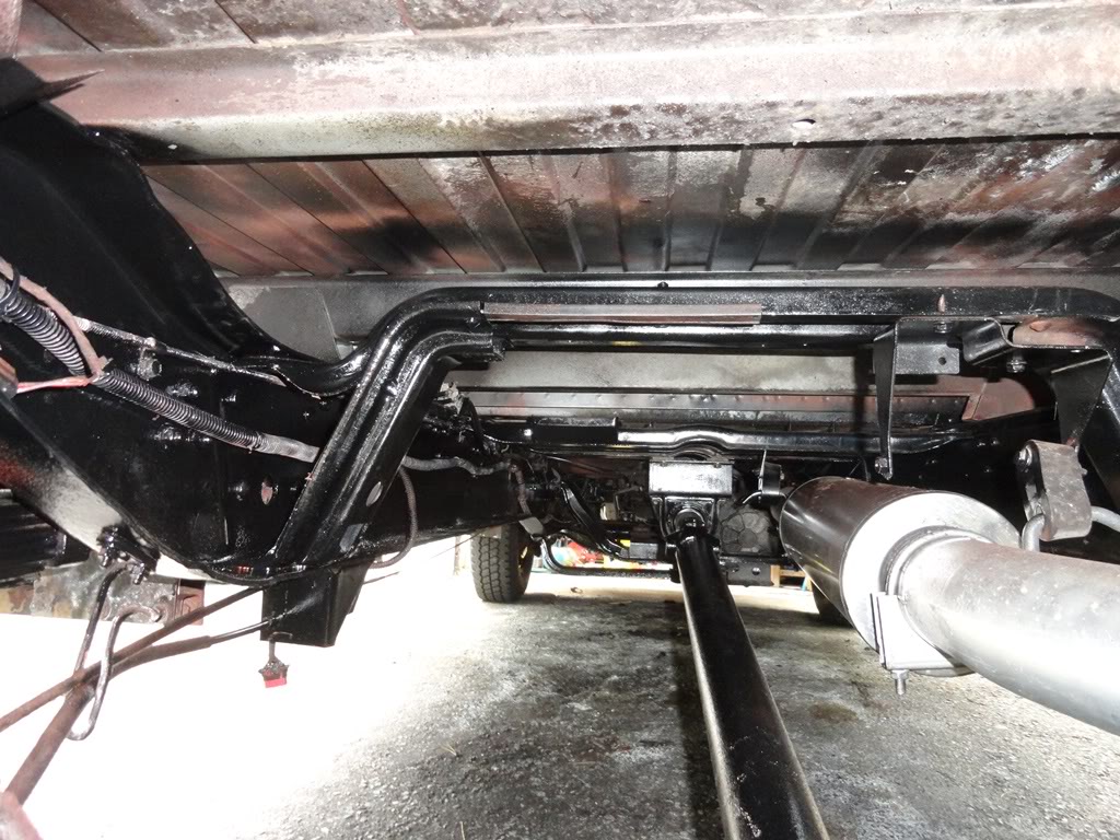

This is what it should look like behind our fuel tanks.... but I'm sure not many do... For the hour to remove the tank, switch the sending unit and spend a few hours cleaning / and protecting the frame, since this is the area that causes so much grief, maybe when someone buys one of these trucks, it should have a sticker on it that says.... Drop your tank... you ****! or maybe not

That diamond eye exhaust is so darned cool. A tight fit.... but cool

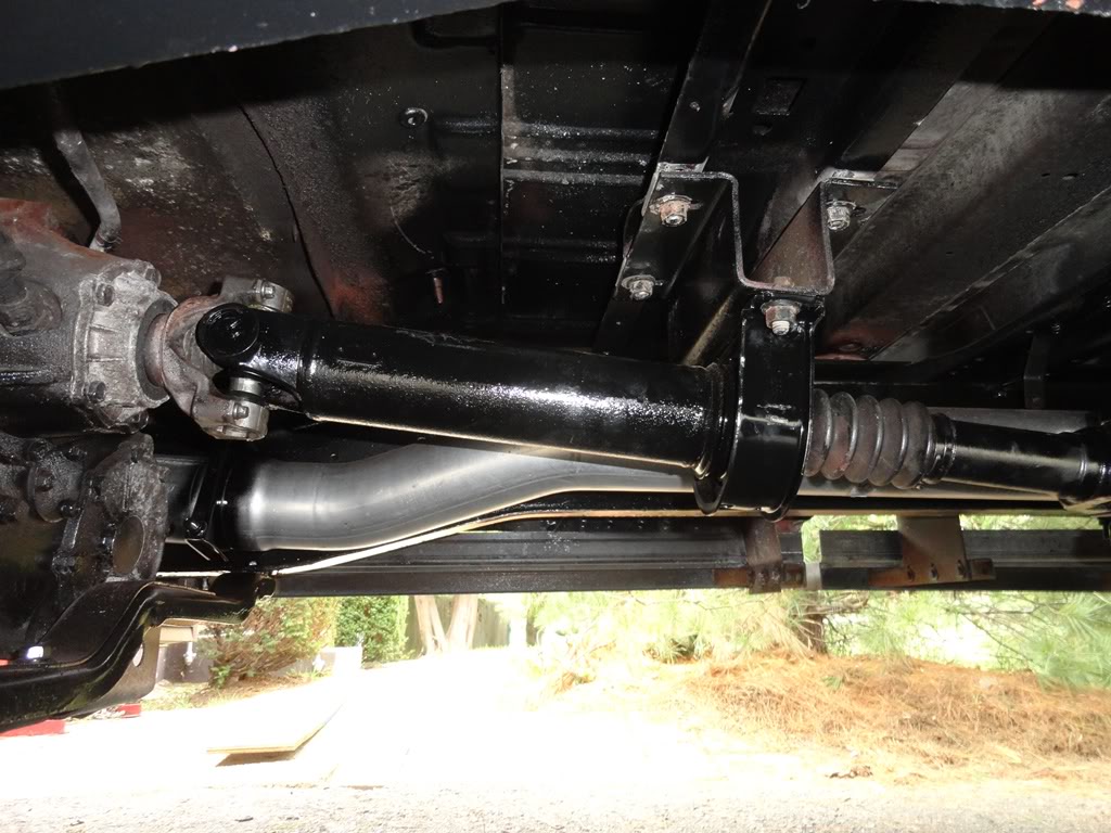

I installed a new driveshaft carrier bearing from Rock Auto. New Napa u-joints and it's waiting to be driven again. I dumped the rear diff fluid today as well and filled it up with some new gear oil, oil stabilizer and LTD slip goo. I have a few other odds and ends to do, such as the tranny service, rear brake adjustment, parking brake cable adjustment, and clean it up...

Next is to dump that cap on the box, and get er sprayed in black Linex or Rhino. Haven't decided which one yet.
I'll be good for the winter.
