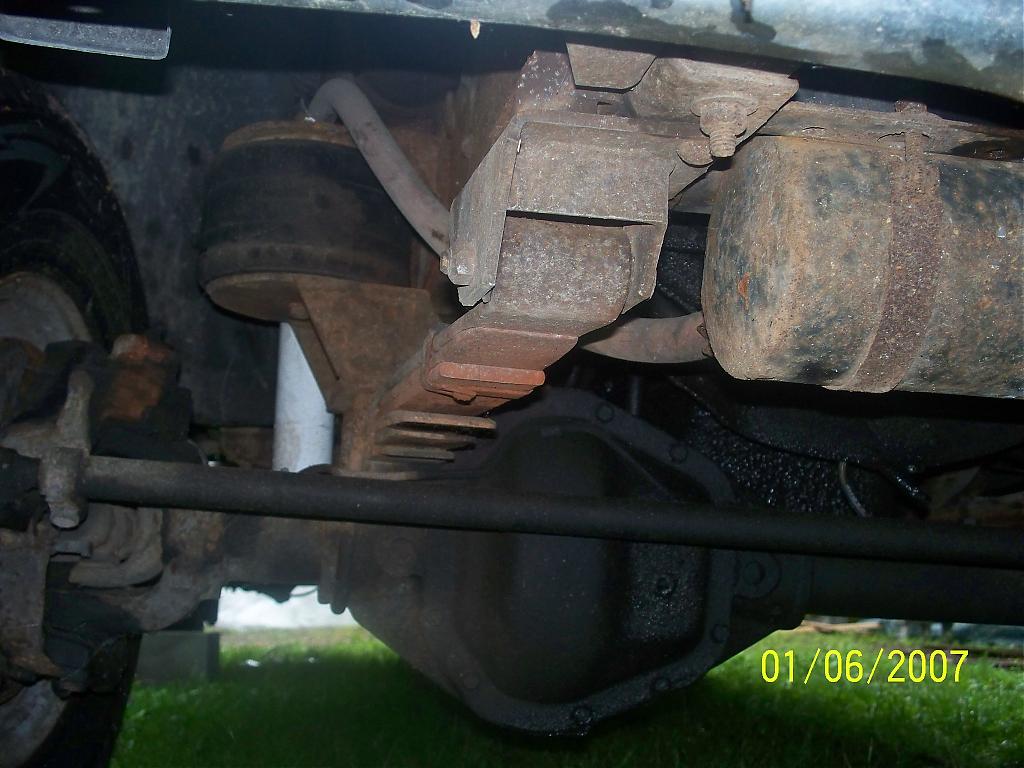

Originally Posted by mhuppertz
Wow, I really don't understand what I am looking at there!
How it works is they remove the rear spring hangers and bolt them to the kelderman set up and that is what controls the ride and stance. Here is a pic of the side you can see what I mean by remove the rear spring hangers.

Originally Posted by DNRCustoms
I would be interested in a pic of the front setup... I'm actually considering 4 linking the front and rear and going air at all 4 corners..
Here is a pic of the front. Its just 2 bags one on each leaf and air is supplied by a tank you fill with a regular air hose. From empty to 28 psi it raises about 2 1/2 to 3". Sorry I thought I had more. In the picture you can see the bag in the center and then to the right of the spring is the tank with the hose going to the top of the bag.

That's crazy, my Kelderman system is completely different.
The front looks like in the picture, but in the rear I have air bags on each side (like in the front) except the whole system works together (not two seperate systems like the front).
My rear system incorporates the receiver as well.
As to part numbers for Kelderman, I'm pretty sure it's just a few old dudes working there. Give them a call, they're pretty friendly.

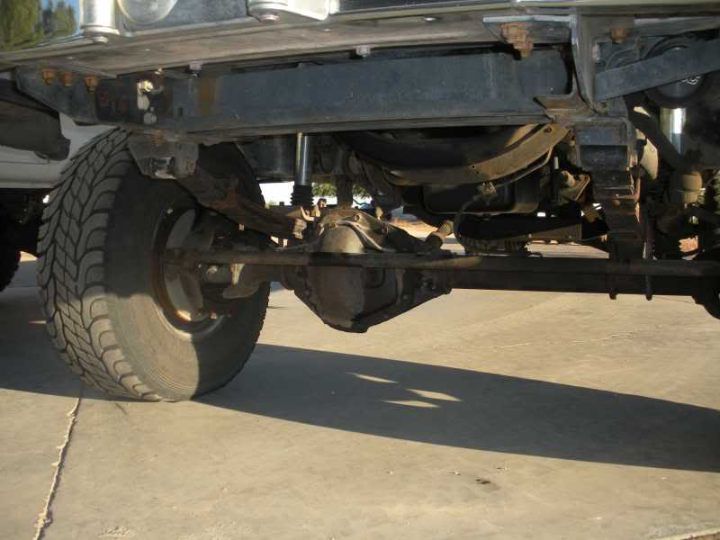

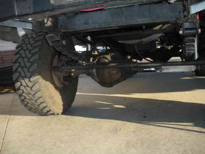

You can also look into www.alcanspring.com for replacement springs. For the front, they do make a very noticeable ride difference on my RamCharger. For the rear, the spring rate is close to factory, so the ride plus 3 inch lift is nice.
They use multiple leaves, but of differing thickness material, to survive under the Cummins, and yet still provide a good ride.
I use the Rancho 9000XLs on it, and they work great too.
If you still have a factory bench seat, that contributes. On my former 93 with 4 inch Skyjacker and Bilstein 5100s, it was better than stock, but I finally switched it to bucket seats, wow! what a ride difference.
Also, lower the pressure more, to around 40-45 rear, and maybe 45-50 front and see how it rides, if on E rated tires only though.
Here's the skyjacker setup 5 leaf fronts:

Here's the Alcan setup 7 leaf fronts:

That's the Keldermann version 1.0. The current setup is like Subliminal's. They changed it because the old setup had no place for the spare tire.
