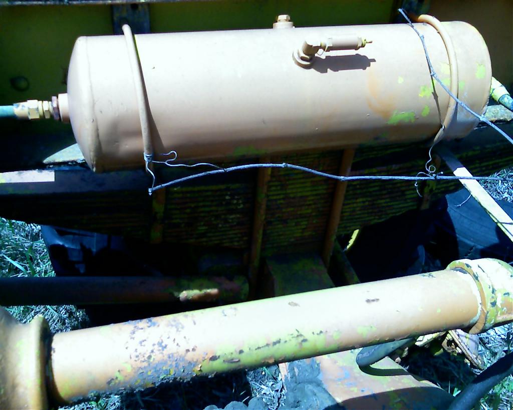

Heavier duty trucks (for example, the school bus I drive) often only have 1 or 2 really big leaves per corner. The front axle has two leaves per side that are very wide and long. The rear has an arrangement that's something like one "main" leaf, and the other 2-3 rear leaves are hung like normal at the front, but ride on an "overload" thing at the back. So basically you're only riding on one leaf until it needs more. Of course it's still a bumpy ride, but considering the 30k GVWR it rides a lot better than my Dodge even when empty. My dodge has 13 leaves per side in the back, of the usual length and width.
My guess is that it's just plain better to have less leaves that are thicker and wider. I took this picture of an ancient Oshkosh snowplow at a junkyard last year... you can't really see it behind the air tank, but there's another 15 or so leaves just in the overload on top of the regular spring pack (which is visible)!
Attached Thumbnails Any way to improve ride quality?-junkyard_ridiculoussprings.jpg

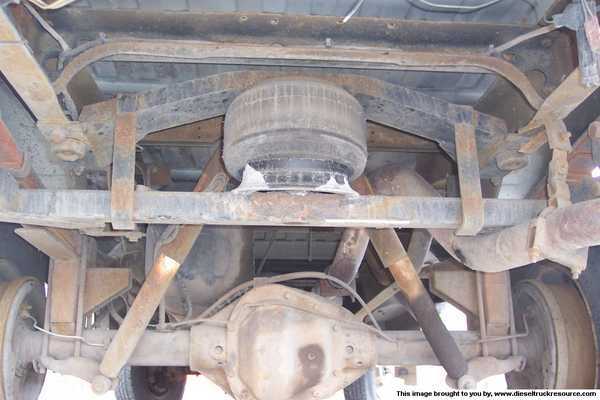

I run a kelderman system up front and out back. The front is controled using a air tank the back using a compressor under the hood and I have rough country nitro charged shocks and compared to all the other 1st gens I have ridden in mine feels like a caddy. Here is a pic of the rear fully extended (6" total lift). It's a old picture with the blown out monroe's on it.
