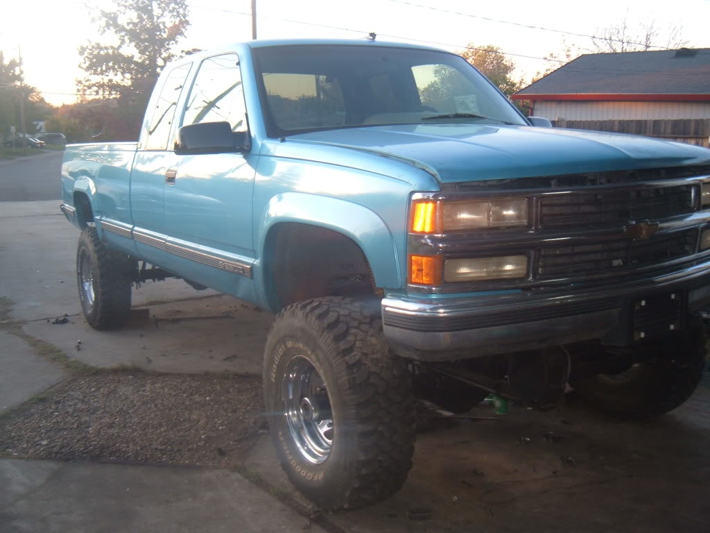

And some questions need to be answered first. We need to know what your intended use is for this rig. If it is going anywhere other than to get groceries, you better think long and hard about putting a passenger drop Chevy D60 underneath and get rid of that IFS junk. Fab skills crucial of course.
This conversion has been done before on same era chevy 3/4 ton pickups, and I know someone you should talk to. His name is trevor and here are his pics. PM me for his # and you can chat with him.
http://s837.photobucket.com/albums/z...arts/?start=20
