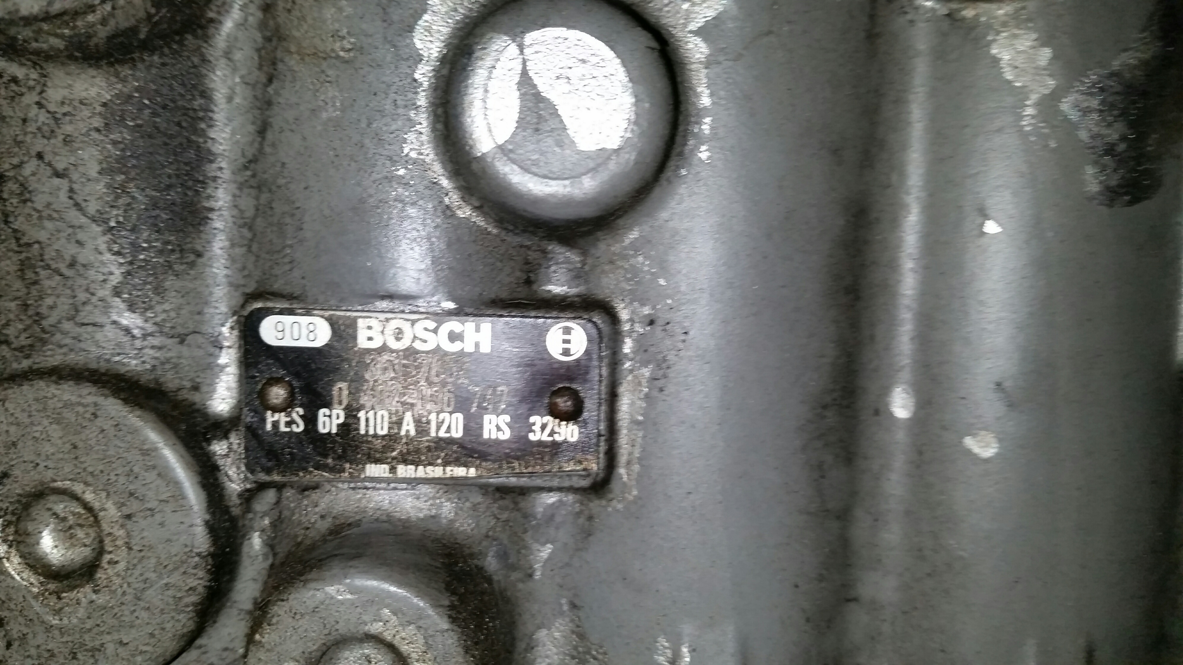

I added pics of the pump tags . Not sure if I'm being stubborn or cheap but , can you tell by the tags what they are & if they are any good ?
So is it the weights & springs that cause it to fuel slow ? Like a distributor ?

I'm not familiar with the Bosch pump markings, but the engine's CPL number is key. You can get a full parts breakdown in cummins quickserve online.

Both tags were covered in oil . No markings left on them . Here is a pic of the 1 that had something left on it .
I think I will go with the ford setup . It's in hand . Once I get through the winter & get my crew cab drive able I will rip into the RC . Plus I can buy parts over time making it budget friendly . I will use this to learn for the next one . I've seen a few dodge pumps for sale . Will worry about that after it's roadworthy . If I had a truck & an idea the parts truck would be best way to go . To get the parts I already have I would be looking at over $4k .
