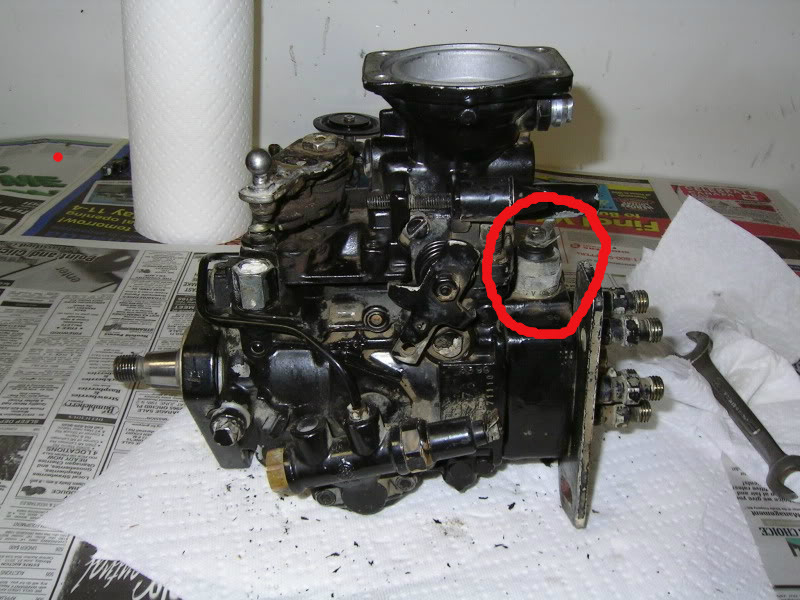

Nope your not checking the manual shut down lever...you need to check the FSS (Facotry Shut down solenoid) This is the round-ish brass unit that mounts at the top, back of the IP , near where the main injecotr lines hook up.
here it is circled in red...

yeah i'm thinking it clicked and i didn't notice it...I'm waiting for a friend to bring his multimeter and test the fss and then i'm going to go from there...thanks guys
