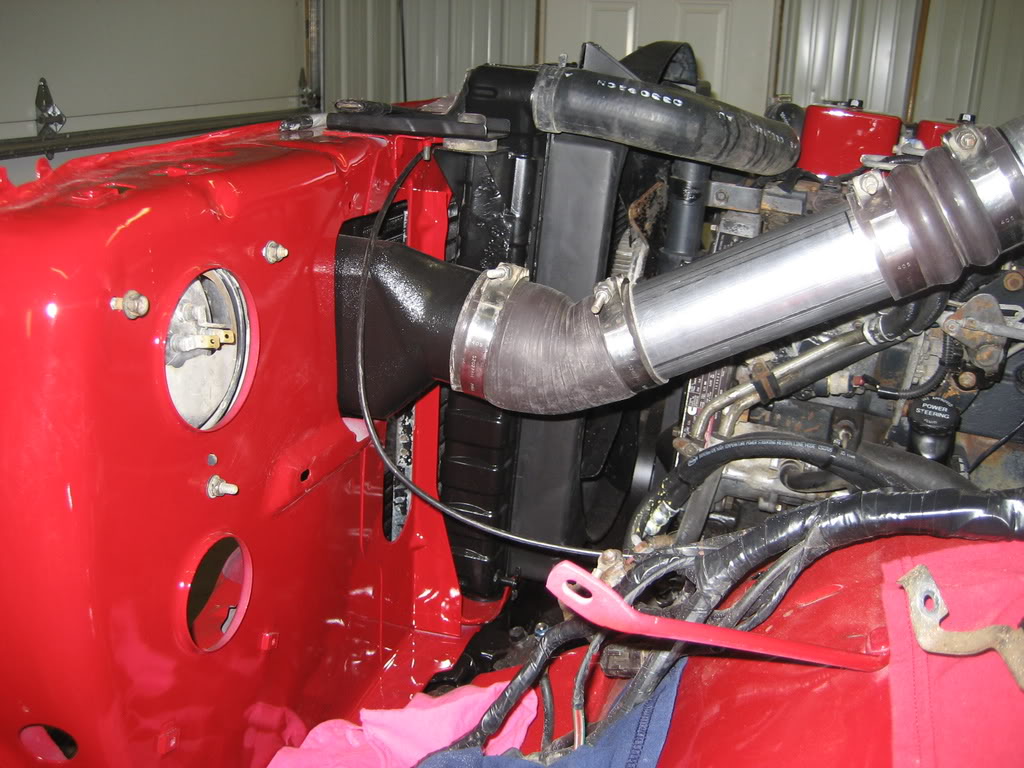

DNR Customs got a finished pic? What did you use for intercooler pipes and intake horn?
Nice work
Old Nov 30, 2009 | 08:11 AM
DNRCustoms's Avatar
Posts: 1,341
From: Richmond, MI
I used exhaust tubing for the straight section along with the intake horn. Took a couple bends and welded them together for the intake horn. The other pieces were straight. worked out awesome.
You can see the pipe under the cold air tube, straight shot to the turbo elbow. no bends!!
