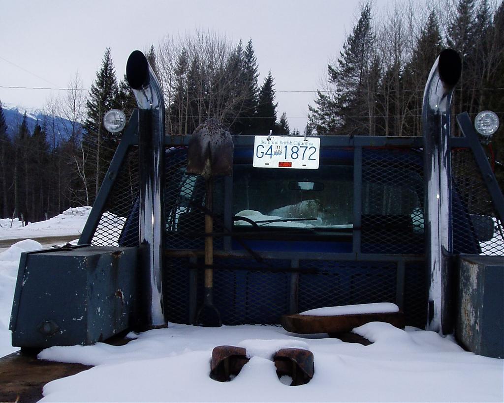

Thanks for the info on the Black module..I did not know that but it will help with the '92 that is in the picture as it has issues with the ABS....will it do anything to things in a bad way if I unplug them?
