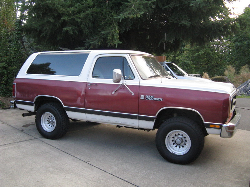

Here is the Ramcharger
Here is the Ramcharger, along with the other two. It has a few dents and dings, but ran well getting me home and anything you can drive for 12 hours can't be too bad. Cruise worked well, passenger window needs some help but the drivers worked fine. No rust which was my main concern and the undercarriage is surprisingly clean. The gas shocks will even hold up the rear hatch.
I can't wait to get the 12v in as the fuel mileage is horrible with the 3 sp auto and carbed 360, glad fuel came down.
Couple questions as I need to figure out how to use my front end out of the 96. Not having a 1st gen truck I am not 100% sure how the Dana 60 look out of them. Mine has a Drivers side drop which is fine because I am going to use my transfer case and NV4500, but... I can cut the coil buckets off and add some spring perches, just not sure how to get the steering done as I don't have kingpins and can't add the "arm" for the ramcharger steering linkage. My linkages would hit the springs.
Should be fun, right now I am getting everything I need so I can't tear them both down and get it back on the road mechanically sound and than start on the body etc. I am going to need new springs in the front to hold the extra weight along with 4" more lift. Next to my 04 it actually sits pretty low.
Thanks,
