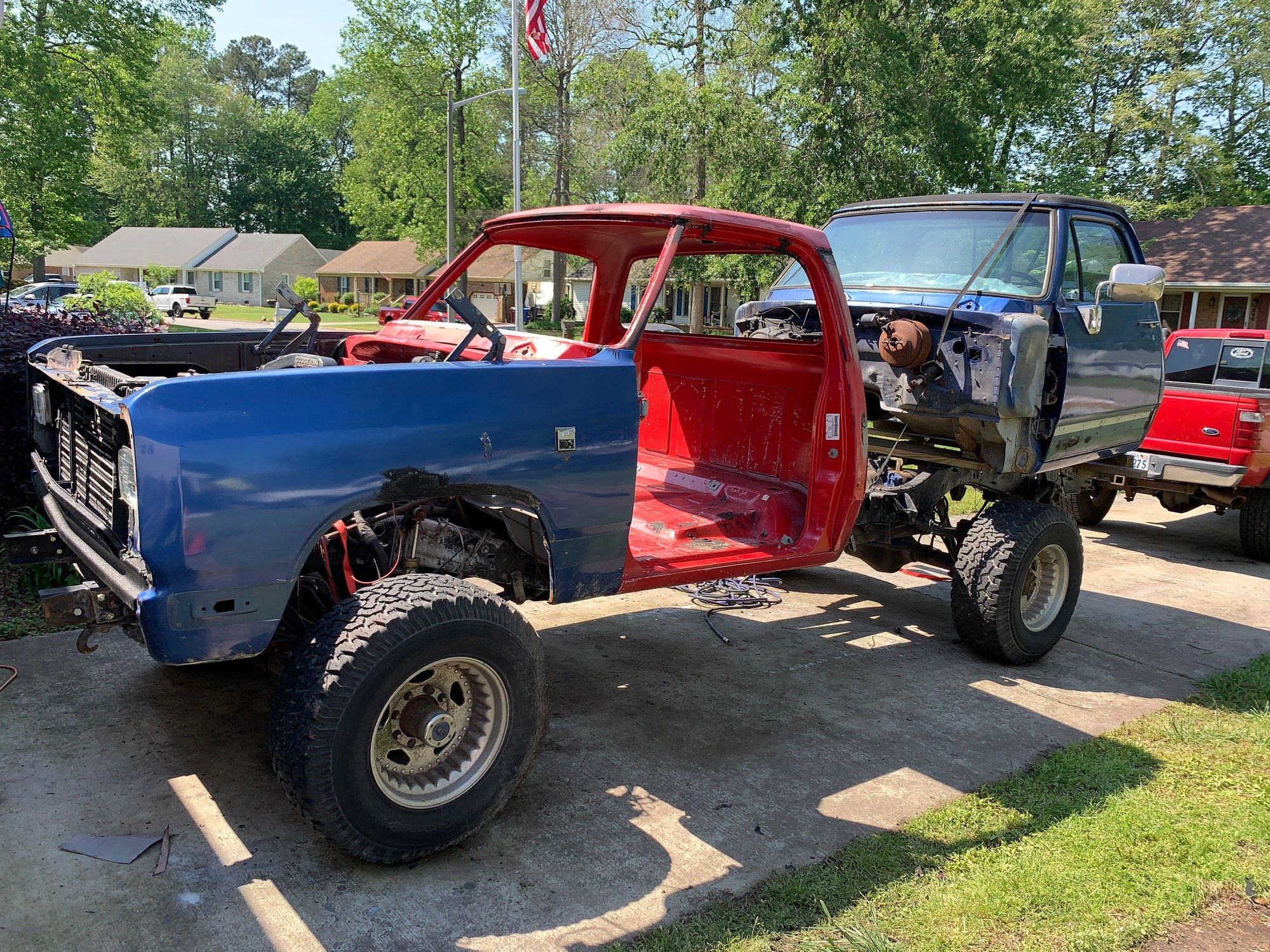

I am in the process of doing exactly what you mentioned. Took 4 guys to slide the fully assembled cab to the back of the frame and 3 of us to get the bare cab onto the frame. Swapping out the good from the old cab to new one. Biggest pain will be the windshield and back window.

Joined: Dec 2004
Posts: 4,312
Likes: 1,063
From: Commerce, OK
If you're like me you could save some time and just go ahead and bust the windshield.
