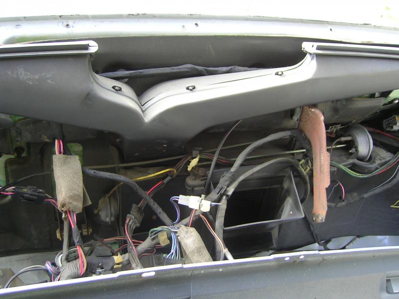

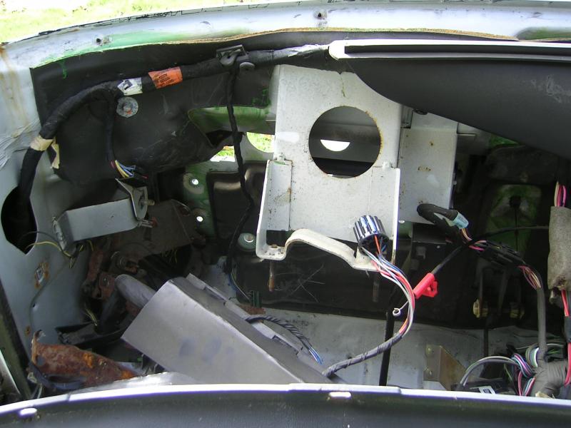

The wiring harness for the power windows, power mirrors and door locks, is up under the dash, behind the defroster vent ducting. It is secured to the inside of the firewall.
Here is what it looks like...

Chances are if your truck was built with manual windows, and locks, then this harness is not present.
